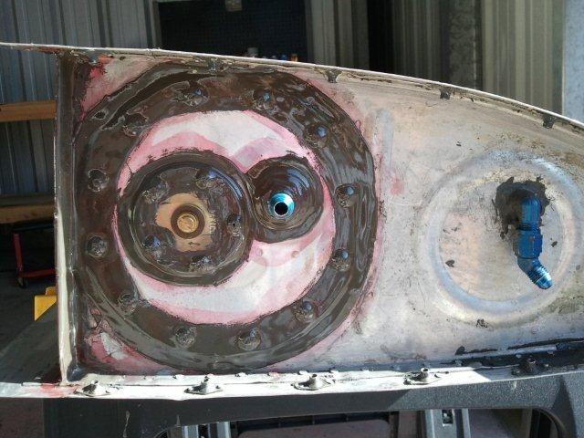

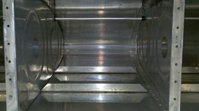

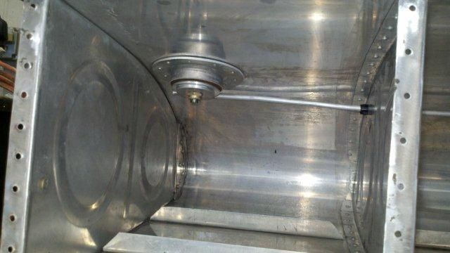

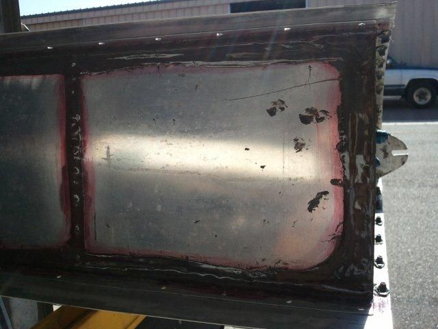

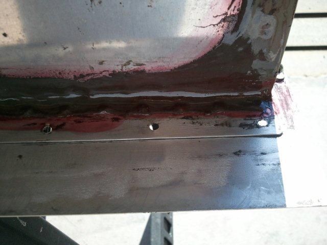

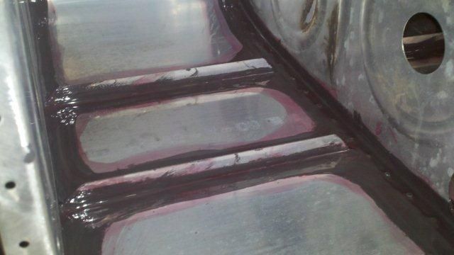

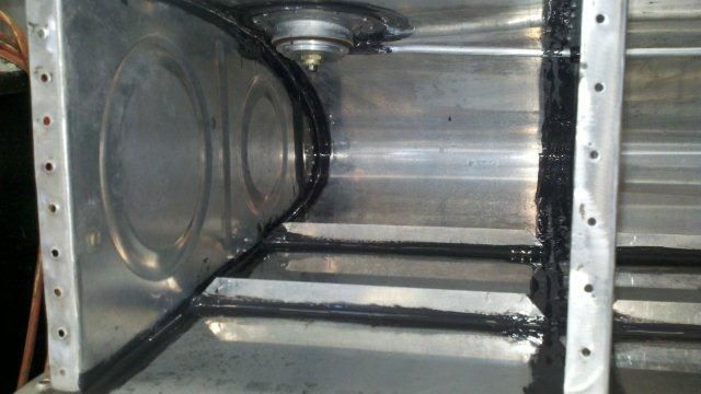

I would like to add to Kevin?s review of Paul Beck of WeepNoMoreLLC mentioned above. I bought my RV-6A with QB tanks about a year ago and have been troubleshooting a leak in the left tank. My tank troubles have been documented here on VAF. I, thanks to a lot of advice on VAF and RVr?s around me, tried twice to reseal the tank. I was successful in slowing the leak, but in the end felt like I was merely chasing a leak. There was evidence that the owner before me had done the same thing, so it was time for more serious repair, so I gave Paul a call.
Paul specializes in Mooney fuel tanks, but does RV tanks ?For Fun!? (His words, not mine! Personally I think his shop is not ventilated and the fumes are going to his head!) I won?t go into detail of ?how? the tank is resealed, as that can be seen on his website Weep No More. I talked to Paul about my tank and he explained everything in detail.
I am in the process of moving to Rhode Island, so my timeline is tight. Paul gladly made a spot for me in his schedule and even finished the tank 2 days ahead of schedule. So the tank is back on the plane ?leak free? ready for my cross country move. Just like Kevin, Paul shipped the tank before I paid and emailed me an invoice. Paul also noticed an increase in the shipping rate by UPS after the tank had been mailed back to me and offered to pay the extra shipping. What a stand up guy!
Below are some pictures of the tank:
Tank cleaned:
Tank Sealed:
Completed tank:
Look at the detail where Paul trimmed the sealant back, so the tank would reinstall flush:
New rivets installed and painted by Paul:
This process may not be for everyone, and it is not a cheap endeavor, but if you are struggling with a leaking tank and need help, Paul Beck is your man!

Default What is the pink material?
Does anyone know what the pink coloured primer like material is underneath the Proseal?
Doug Gray
RV-6 completed, flying since July 2010
Old 06-26-2012, 05:57 AM
Walt's Avatar
Walt Walt is offline
Join Date: Aug 2005
Location: Dallas/Ft Worth, TX
Posts: 5,667
I believe that is a top brush coat of some type.

Default Pink Sealer
Doug,
Got a reply back from Paul
The red color is a top coat for the sealer. Mooney has used it since
forever! Its a synthetic rubber that offers protection for the new
sealer. It acts as an isolator so the fuel never really touches the
sealer. Also, fills any microsopic holes that may be In the sealer,
making for a more secure seal job.
Paul is working on a VAF account and becoming a VAF advertiser.
Dan
