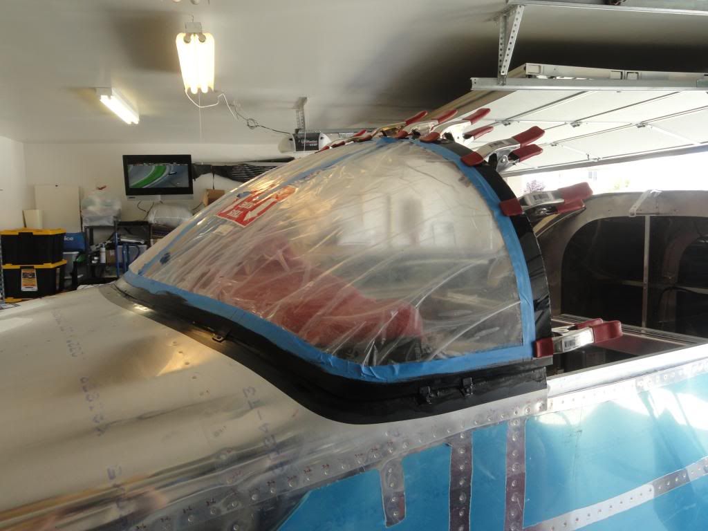

Have been busy myself, got the windscreen glued in yesterday and the cowl fitted with the Skybolt system last weekend.
