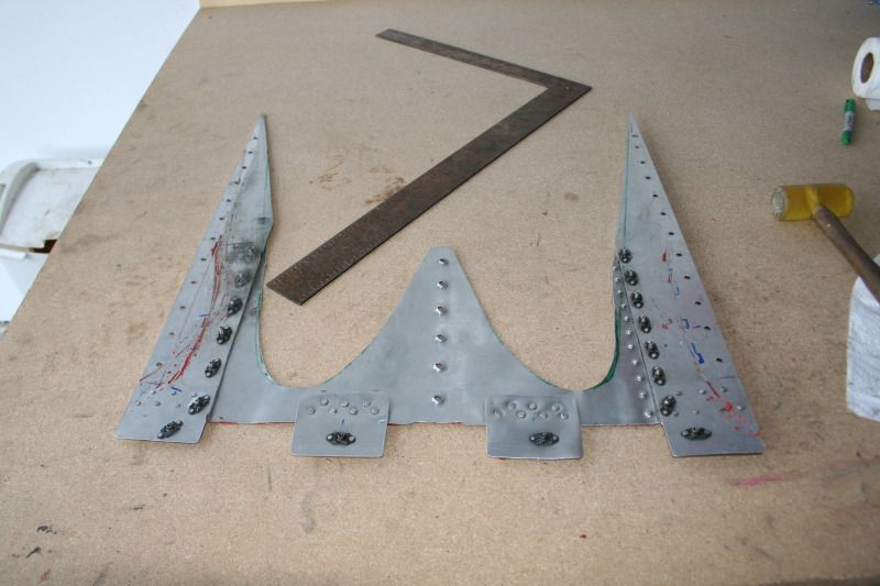

Next I have to convert this development patch work cover and outboard fins into a single piece and retain the center fin as is - hopefully in the next few days.

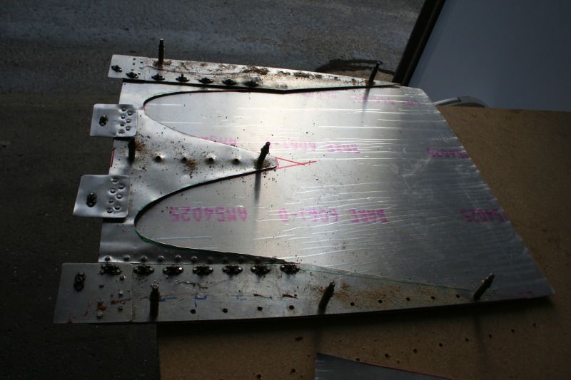

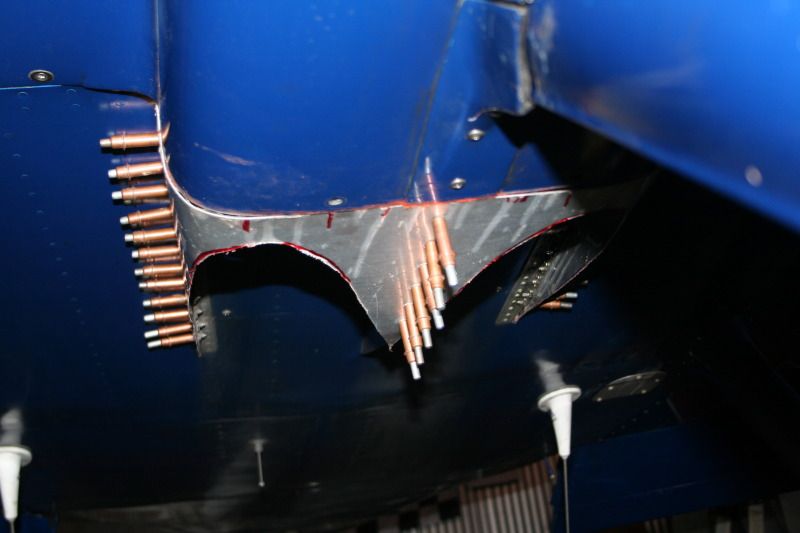

The development cover and outboard fences unrolled to pattern flatness.
I had some 0.040" 6061 O bare so that is the first (hopefully the last) single piece copy:
I fit well:
