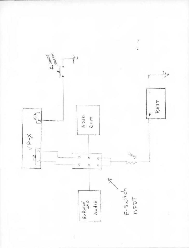

Default E-Bus planning
I am trying to configure an "E" bus. My Dynon D-1000 has it's own backup power as does the Gemini PFD. I can live without xponder, flaps, trim etc. Therefore, I think all I need is a radio. Here is a proposed drawing (crude) of my planned E-Bus wiring to use with my VP-X pro. Does anyone see a problem with this approach or have a better idea? Thanks in advance.

I am wiring my GTN650 Nav and Comm power to my alternate buss. Will I need to add my PAR100EX audio panel power to get the comm audio from the 650? I think the answer is yes, but just wanted confirmation.
Most audio panel's have a fail safe mode that they will revert to when powered off. Typically this routes the #1 COM to the Pilot's jacks.
However, confirm with Mark for your setup....

Brian, thanks for the heads up. I just checked and the Garmin 240 does have a fail safe power interrupt--headset, mic and PTT all default to Com 1. So, I can remove the audio panel from my "E" bus. With the audio panel is removed, does anyone see any other issues with my "E" bus schematic?

Steve,
Your drawing is as specified in the VP-X installation manual as a "backup method B." The only change is that you should have a dedicated fuse for each device you are powering. The fusing should match what you have configured in the VP-X for those circuits. I'll add clarification to the install manual about this.
Of course, since you can eliminate the audio panel then, in your case, you'll only need one fuse.

Originally Posted by KRviator View Post
My switch for the E-buss is labelled A'la A320, "EMER ELEC", will be a guarded, lever-latch toggle from Stein. In the normal position, power for the battery contactor passes through one side. When configured for non-normal operation, the contractor is opened, de-energizing the VP-X, and closing a small relay powering the E-buss.
While this should work, it is more complex than it needs to be. I'd suggest using backup method B or C as described in the VP-X installation manual and keep things simple.
