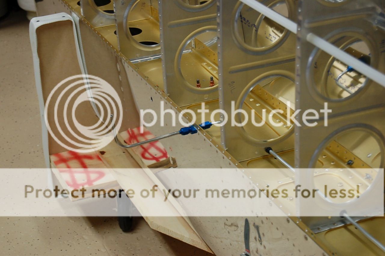

Yesterday I came from a bumpy ride. I have plenty of them Cousin showed up in his Tweety bird and started looking around to find a subject for criticism as he always does. He noticed a 0.5 degree angle on Vans pitot tube. I usually don't believe him but this time I checked. The blue anodized nut was loose I was able to unscrew it with my fingers. Check yours, tighten to specs and torque seal it.

I check mine on every flight, as I remove/replace my pitot cover. I did find it loose once.
I note that in your picture you have a unique configuration for your pitot. I didn't know you could get them to work in reverse?

I got a few "weird things" in my plane Rob good catch.This picture was taken in 2007 I knew nothing about pitots then Your RV is Tweety too? What's the story behind the nickname?
