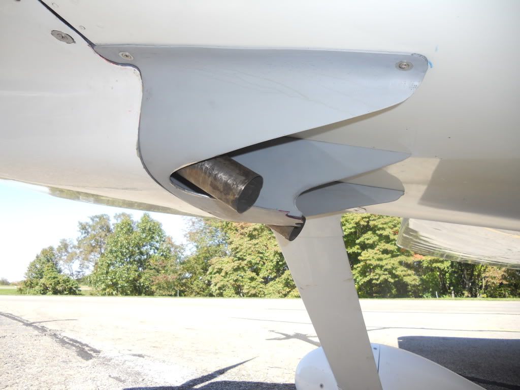

I have looked at your fairing and the references you provided. I see what you are doing with the external vertical surface, the center vane, the cutouts around the pipes and everything I see makes perfect sense. I am curious about the two scalops in the trailing edge of the horizontal part of your fairing they are too inconsistent with the basic smooth lines to be accidental and they obviously will affect the flow coming across that high pressure area and rising into the void. I suspect that is your intent and it looks just right. Did you try different shapes on this edge? Another observation that I should keep to myself, since we are in the same racing class I believe; I can easily visualize the effect of the center vane and it seems to me that this would be enhanced by extending it back farther than the tapered side dams.

I wanted to keep as much horizontal "floor" in the fairing as possible to acheive as much airflow fairing as possible. So for that reason, I tried to keep the radius close into the exhaust pipe as much as possible while also keeping the curve smooth and asthetic.
When I got out to the end, I had some width left to transition at the end. What to do? Cut it off flush?? round it off? I just picked the scalloped, bat wing curves because it looked cool (I thought) and is maybe aerodynamic (works for bats!).
My original design had an overall longer fairing and an even longer center bluff body. I trimmed it all shorter as I went, again basically to get it into asthetic proportion and be faired to the eye. Longer might be better, especially if you are going for a wider center body to reduce exit area more (or to fair more of the nose strut in the case of an A model). Check this example for long and faired http://aerochia.com/parts_images/ES_3_lrg.jpg
Dan, I think that the explanation of how mass flow could go up and still see a decrease in drag lies in just how draggy the stock 6/7/9 exit is. When could you send me a loaner probe??

Bob,
This will help everyone visualize the A model problems.
I am consulting some good advise on the gear mount and think
I have a good solution to the problem.
I do like what Gary has done.
I did lose the holder for the cowl halves. This was a one time flight on
this setup and now have a 6" x 10" plate that goes over the split in
the seam.
Not taking very many readings just trying to get the oil temp down
and velocity up in this area.
