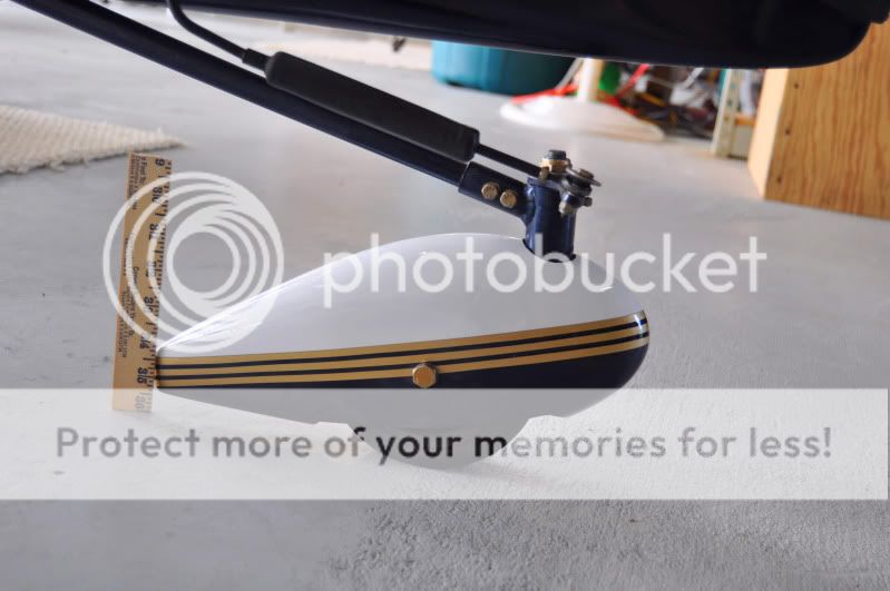

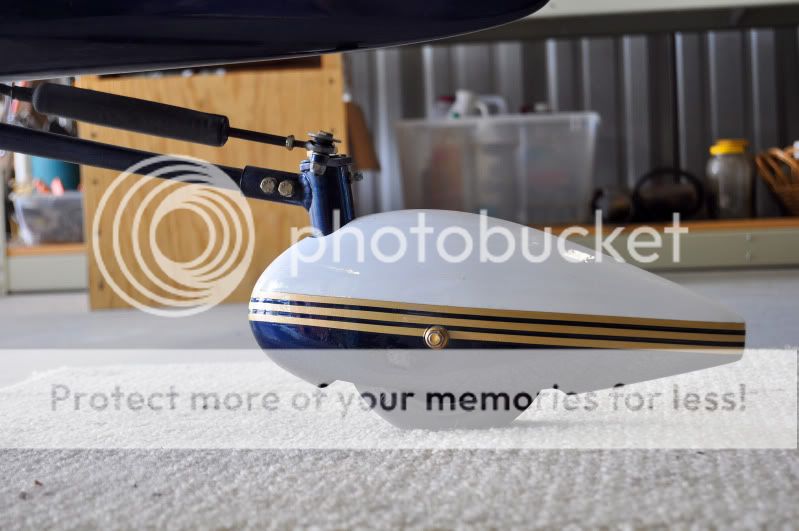

I've go two of Vince's tailwheels and couldn't be happier with them. One is for a fairing and the other for grass strips, etc. As Tom Martin said, Vince's fork really makes it easy to use Van's tailwheel fairing. I permanently glassed the fairing to the fork which makes the fairing really solid. Just takes a few minutes to change them out.
Oh yeah, and since I took these pictures, I also switched to the tapered pins instead of the two AN3 bolts shown here. Highly recommended also.
Looks like Vince's gear is the way to go including the rocket steering link.
This makes a really nice clean setup.
