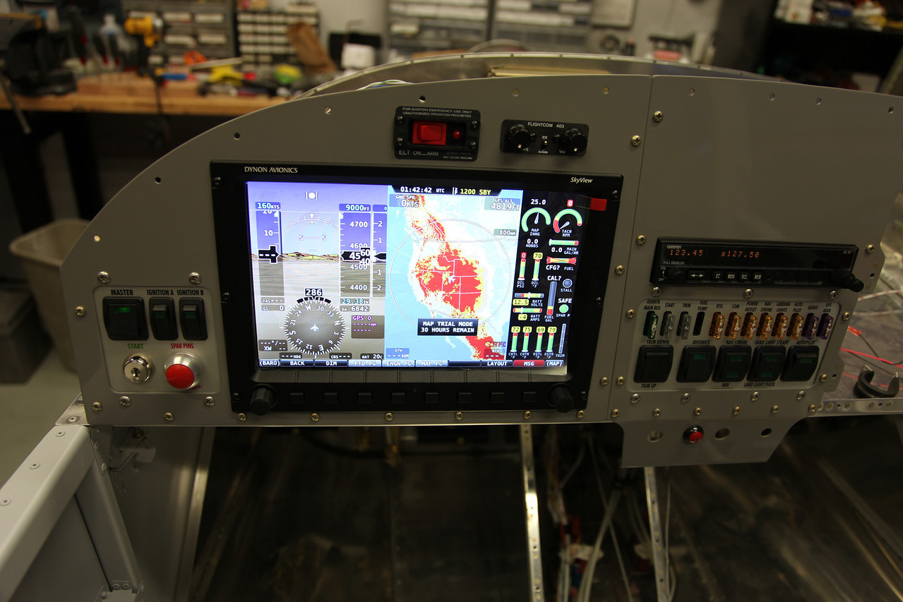

MITCH - you opinion on the below please!

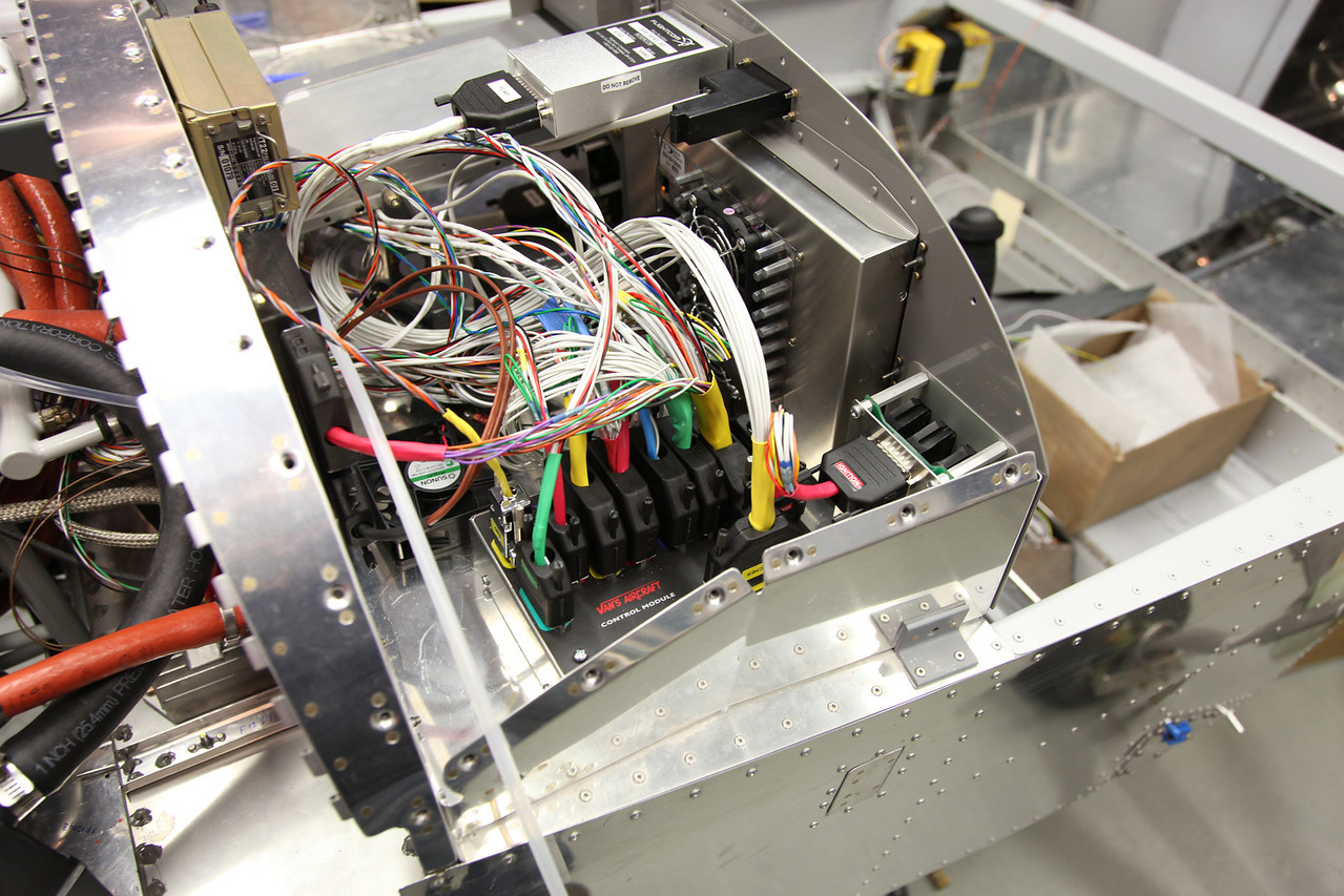

I was dreading page 42D-25. This is the page where you add the diode to the bottom relay on the firewall. This is a difficult place to get to if the engine is already installed. I found that by lifting out the oil tank (mine is still empty) and removing the two bands that hold it, I was able to get my hand in there for the tough part - bolt removal and replacement. With a very flat, small ratchet wrench the job was actually easy, only took a few minutes. Whew!
I did all of the pitot-static revisions in the tail, and installed the ADAHRS. I used foam padding and a long board to rest on and supported the tail on a table with more foam padding. I revised the OAT wires and plugged them into the ADAHRS. That leaves 4 wires that originally plugged into the DB-9 in the tail. The plans say remove them from the DB-9 totally and abandon them in place. The plans say clearly that they are no longer used. Hmmmm.....

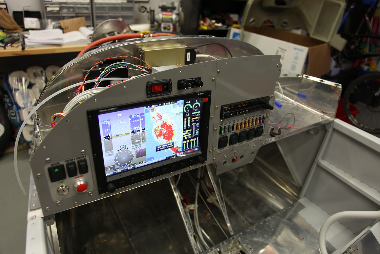

Now on to the last major task - routing those new harnesses and the new wires to the tailcone (not looking forward to that. Tough working inside the cabin, lying flat, etc.) What goes to the tailcone in the Skyview are 2 twisted-pair sets, and a single cable with 4 wires in it. All of those go into the old DB-9 connector (now empty).
Now, something interesting. The plans say to pull the pitot tubing back from the panel all the way to the aft fuel pump. This is to clear space in the very-tightly-packed snap bushings in the main fuselage member for pulling these new wires. Then you put the pitot tube back. This doesn't sound like fun. It occurs to me that by removing those abandon-in-place wires (i.e. cut/seal them at the panel end and pull them aft) , that also frees up space - and they might be usable as pulling wires for the new ones. I will check into that.
Mitch - your opinion???

The right side panel with just the map box hole in it (no intercom or ELT switch hole) was about $15 from Vans. I used the old right side panel to add the correct hole for the ELT switch above the left side panel with the Skyview cutout. Check my facebook album for the latest pics that show that - public link here - also note the panel covering -
http://www.facebook.com/album.php?ai...7&l=a2b29e894a
