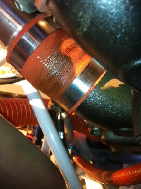

I was checking over the engine today and I'm trying to figure something out. The short rubber hoses that connect the intake tubes to my cold sump all have what appeared to be oil droplets accumulating around the centers inside of the hose clamps. More so on the lower portions of each orange hose. Trying to figure out what the residue was, I wiped one down with white paper and it turned up "blue". Is fuel sweating through the hose? Why is fuel even getting there. Maybe one of you can explain this for me.

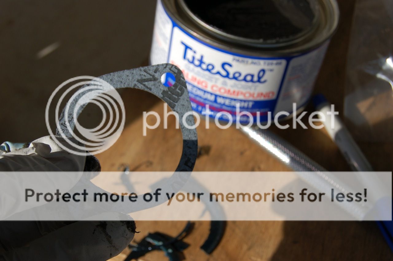

I am currently changing them. Easy. Cheap also. SkyRanch sells them.
I am using TiteSeal on new ones.

WARNING
As for the guy with the photo and a gasket compound in view.....No Way...Naughty Naughty Ask the engine builders, I think they will frown as well.

Well, if gas can seep out then air can seep in. Enough to make a difference? here's a picture of one of my hoses. This was after I wiped it down, but there were fuel droplets present.
