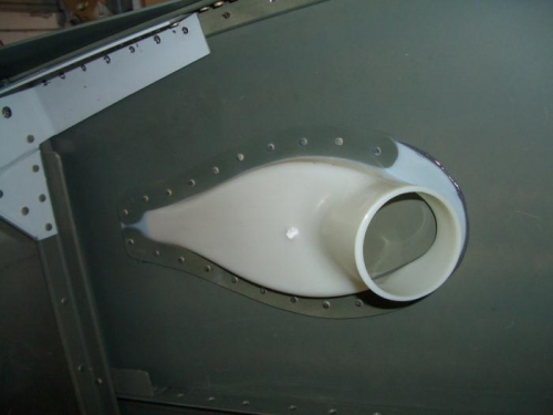

Here is how I installed mine. At the time, I didn't even think about installing with just proseal, nothing wrong with that, just never crossed my mind. I used proseal and rivets. The rivets are probably overkill. The doubler strips are 0.40.
Just make sure install them so you can still get the rudder pedal assembly out! If they are too far aft you will have a problem.
I started by making a cutout template with a staight edge I could use for alignment. If someone want to borrow the template, just shoot me a PM with your address, just make sure I get it back.

Thanks for all the good suggestions posted here but I still wonder about the "official" Vans instructions. Should I assume that there are none for the NACA inlets since nobody has mentioned what page of the instructions or which drawing details it?

From memory, there are some drawings inside the vent kit and they are fairly sketchy as they apply to all models and positions (8 is under the wing).
Keep your entries smooth and don't panic, if you use Proseal or West, they won't fall off....

A FRIEND OF MINE TOM PROCOB INSTALLED HIS WITH NUT PLATES ,MAKES FOR HANDY ACCESS.
Acccess to what ? It would be a small hole to work thru.

I used Proseal to attach the one on the fuselage. I used a retainer ring with nut plates and screws for the one on the underside of the wing. I wanted to easily remove the vent if I ever needed to change the hose that routes the air to the fuselage. I can unscrew and and pull the vent out through the hole in the wing to remove the hose clamp that holds the hose. Removing this clamp would not be easy with the wing installed. I know the hose will last a long time, but I plan to have my plan even longer than a long time

One additional thing I did with the vents was to install a piece of screen over the interior end of the vent (before installing the scat tube.) If you have ever had a wasp sneak into your cockpit, you understand why!
It also keeps larger pests from finding a way in while the plane is parked.
