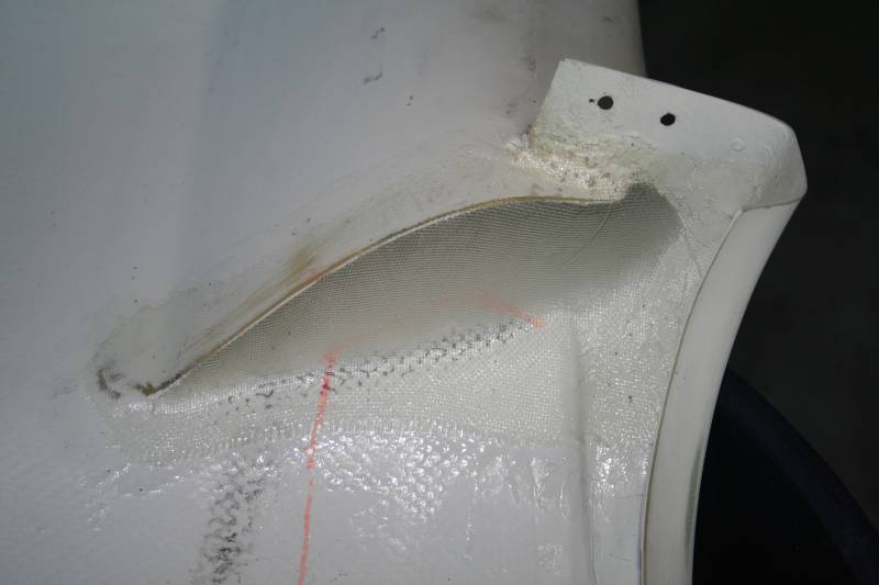

Here's a before picture. Where you see the black sharpie lines is where
I glass in the openings. You really only need to do the inboard side.
I'll post some pics of the completed cowl this evening.

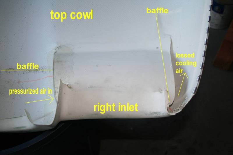

Here's the cowl fix. The fiberglass is laid up vertically. Orange line indicates
where the front baffle is and you can see the scuff marks to the left of the
orange line where the baffle is positively touching the top of the cowl.
Where the orange line intersects the inlet ramp is where the problem area is.
Once it gets under the inlet ramp, if it's not glassed in, it's lost cooling air.
With the glass in place the vertical part of the baffle material has something
positive to push against.
And a picture with a few arrows and such. (ignore spelling errors pls)
Walter Tondu
