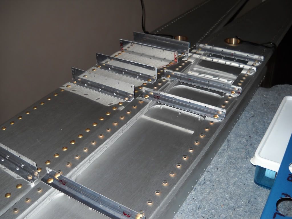

What puzzles me, is the location of the spars within their respective wings. Since they overlap each other, it would seem that one wing will have a spar further forward or backward, by their thickness, so that the leading edges align. Well, Mitch showed me that they do, in fact, align and so do all the rivet lines on both sides, align with the vertical rivet lines of the fuselage.
So what is going on inside the wings to make this alignment happen? Seems that one of the spars should be offset by their thickness.

The spar offset is compensated for by having different length ribs. The forward spar has shorter nose ribs and longer main ribs. Opposite for the aft spar.

The main spar channel is in the same cord wise location in each wing, but the spar cap materials are not. On one wing, all of the spar cap material and the spar stub portion ( the portion that inserts into the fuselage to overlap with the opposite wing spar) is on the front side of the spar channel, and on the other wing it is on the back side. This is what allows the two to over lap each other but still have the wings in the same for/aft position on the fuselage.
So, as Michael pointed out, there is a means for having variable length ribs to accommodate the differences in structure between the left and right wing.

This is the forward face of the right and left spars. The forward ribs are attached to the angles. Note that the angles are of different lengths to allow the spar stubs to overlap in the fuselage.
