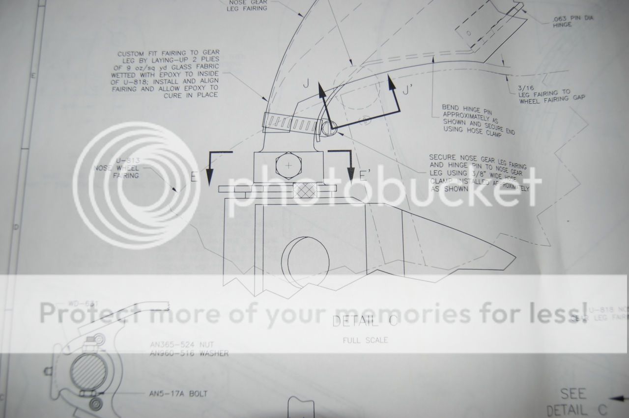

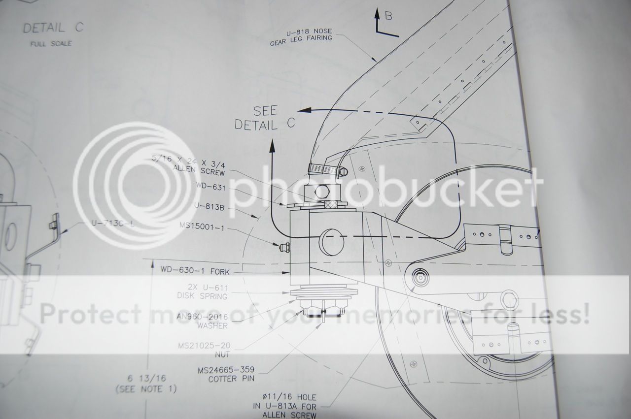

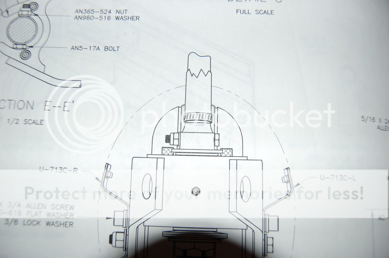

I am having trouble to find right item # in Vans Webstore. I need to replace a hose clamp on nose wheel fairing and can not find matching item. Could somebody please take a look and tell me what kind of 3/8 hose clamp is that?
I installed a larger one and it punctured front half of the pant after full swing.

What about using Spruce?
http://www.aircraftspruce.com/catalo...iconeclamp.php
This one has a lining and may help with chafing.

I would just go to the nearest auto parts store.

Mine did the same from day one so I removed it and used a big zip tie. Put the locking area directly to the rear works great.

I prefer to use the high quality hose clamps that can be found at Marine supply places like West Marine. They sell clamps that are smooth on the inside - they don't cut into the underlying material - be it a hose or your fairing.
I've always been a little surprised that "aviation" hose clamps aren't higher quality.

and eventually tie wraps or hose clamps vibrate loose and the whole fairing moves around on the gearleg. The simple fix is to wrap a few turns of similarly colored electrical tape tightly around the fixture where the clamp would nomally be seated. The tape holds snugly without strain and keeps movement from happening by sticking to the metal gearleg at the aft section of the attach point. Easily removed for inspection with any blade.

I had problems with the hose clamp on my RV-7A front gear. I had it bump off
when I went into my favorite grass strip. Finally I put a wood damping strip
on the front gear like the mains and put a few screws into the wood to hold
the fairing in place. I still have the hose clamp but I don't have as much pressure on it to keep the fairings in place. The wood dampens the vibration
and makes for smoother landings.
