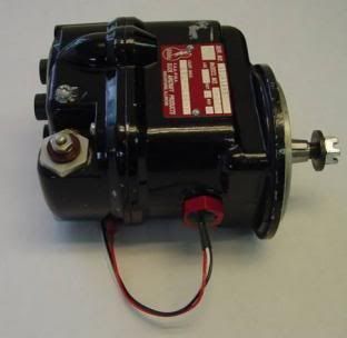

In my above reply I assumed you are using a magnetic tach sensor on the Slick magneto, Like this:
This sensor will output a tach signal of 1 pulse per crankshaft revolution on a 4 cylinder engine regardless of whether or not the magneto is on.
If you are taking the magneto tach signal from the P-lead, then you would want to connect both the magneto and EI tach signals to the EIS.
