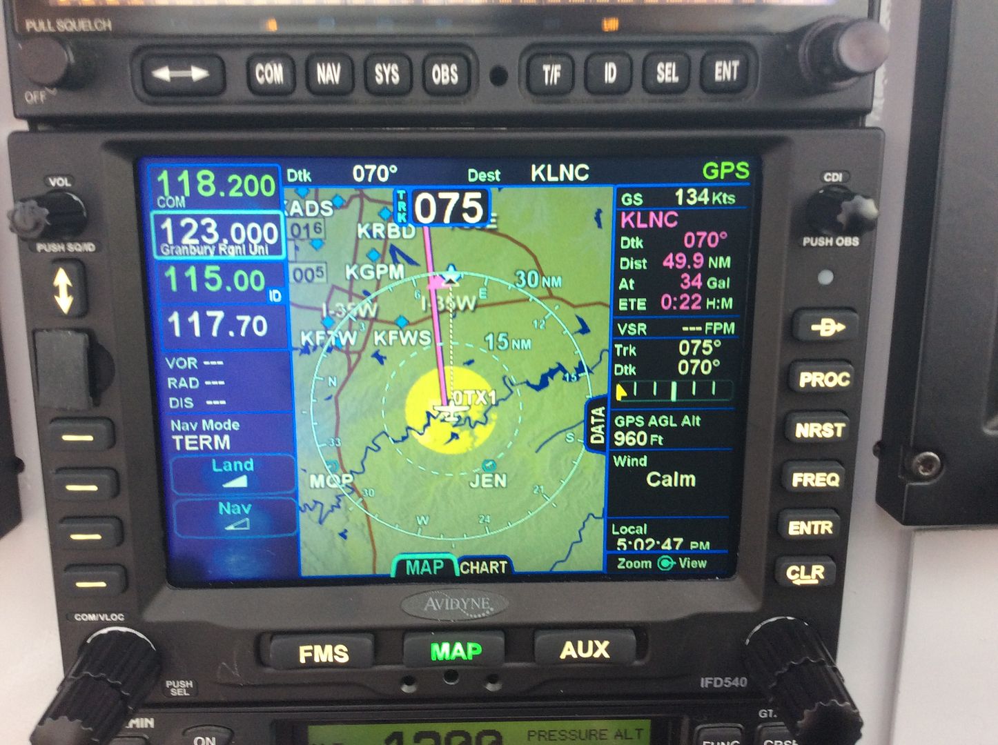

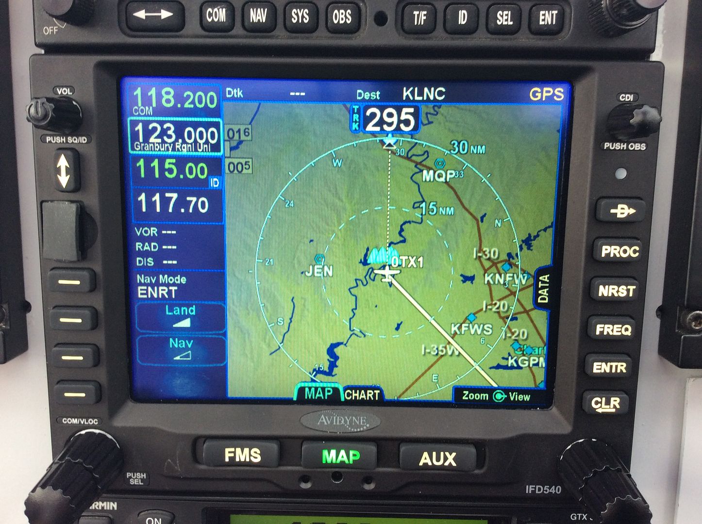

As our RV7a, N967BT, approaches 10 years old, we decided to take advantage of Stein's trade in of Garmin 530W for Avidyne 540. It is really a nice box, just take pictures of the 530W config pages and then update the 540 to match and everything works great. As upgrades go, this has got to be the easiest and quickest one yet!
Avidyne 540 as we start a lunch flyout to Lancaster
Panel with Avidyne 540 in radio stack
Avidyne 540 with data block extended from right on lunch flight.
So our RV7a now has 1502 hours on it with dual PMAGs and is running well. Panel has had a couple upgrades to it and is still the best for us.
