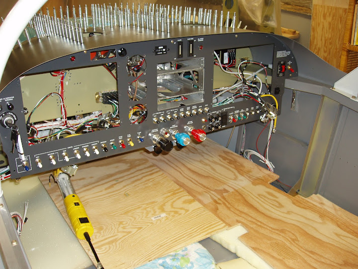

This was one of the things I thought would be the toughest... racking my seventy-something body under the panel to buck those rivets. It turned out to be a lot easier than I thought it would be. Not a piece of cake, but not bad either. I built up the forward cabin floor with thick foam slabs until it more or less matched the height of the center section. I placed more foam in the seat pan area to match the height, then placed thin plywood sheets over the foam, finally an old blanket over the plywood. If the fuel selector is installed, remove the handle and use a plywood cutout to go around the shaft so it doesn't poke you in the back. This allowed me to easily slide under the panel into a comfortable position (and back out). I used a cushion for a head rest. There were only a few places where I had to resort to using pulled flush rivets.
All avionics were removed iin preparation for riveting.
