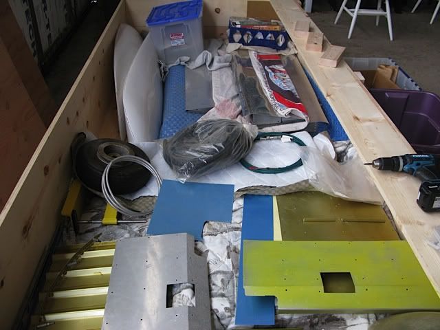

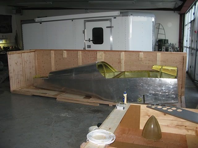

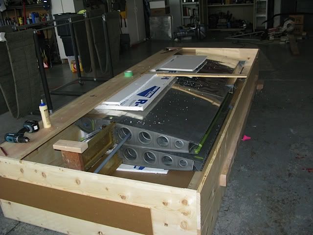

Ok so after 2 months of waiting and countless hours on this great forum my rv6 kit has arrived at the docks ready for me to pick up on Tuesday.
I purchased this QB kit, including wings, emp, and finnishing kit from a person who was unable to continue. I had it checked out before purchased and all the work done was excellent.
My question is after I get it uncrated and on some jigs, and inventory everything....where do I start? Emp has been completed, wings are Finnish and fuselage is QB.
So where would you start?
Thanks AJ
