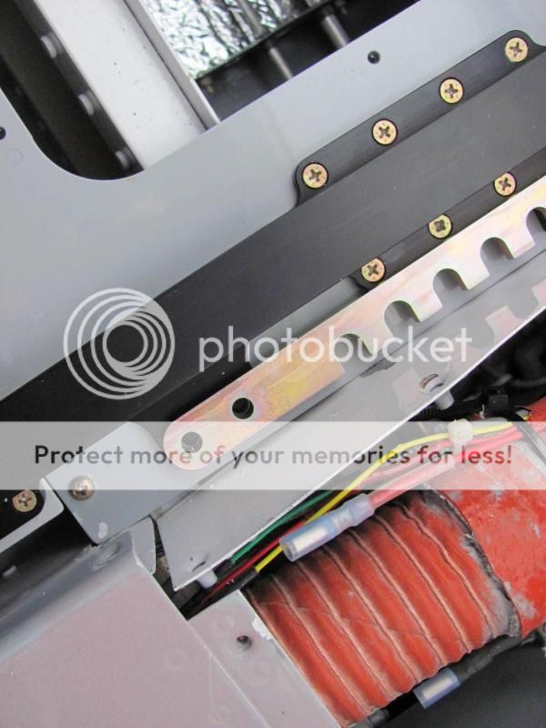

I have the T handle extension that Bob pictured and really like them, but it is still necessary to remove the T handle plate to remove the seat. I tapped threads in the plate so that I could eliminate the nuts. That way the bolts go in from inside the seat frame. As Pierre would say, easy peasy.

No need to install seat, t-handle or flap tube cover until ready for first flight. I just sat on cushions for avionics setup. I will be removing them once a year. The std t-handle is fine unless you have an interior or 1"> fingers.
