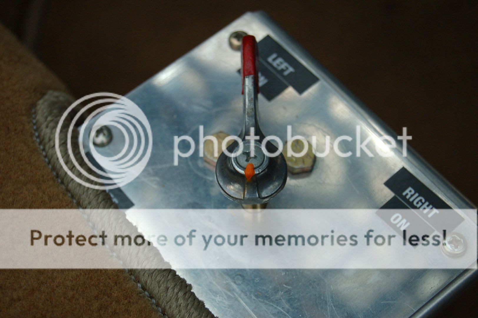

Not sure if Paul had tools on the test flight, but he had it figured before the ground crew arrived. Not sure if the pic is that afternoon or the next morning, but the cowl is still on.
I know a purge valve stop failure would shut it down as Kahuna says, but would that happen with the screw out 1/2 turn...dunno...wouldn't rule it out.
I did have a fuel selector come loose once, when my RV was newer-to-me. Switched tanks and a bit later noticed that fuel was still coming out of the same tank as before (that gauge still decreasing). Handle felt a bit loose, but it was still new to me, so rather than try to switch tanks again, and take a chance of it going halfway (to off), I RTB'd quickly. Sure enough, the screw was backed out enough to allow the handle to turn freely, and catch the key if pushed down while turning.
I was lucky...and had the motor quit, I would have been putting the boost on and changing tanks just like Paul.
I'm going with LoopFuz and Pooner this on this one (fuel selector), though Kahuna's sounds very feasible too.

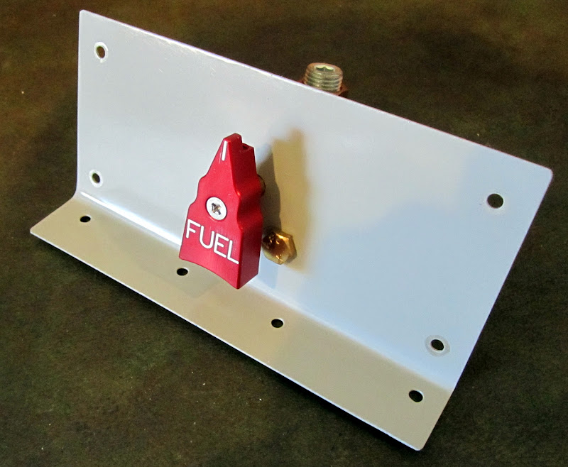

For those that said fuel Selector, you were right on – or close, depending on if you know the trick to this after-market fuel selector handle. This nice little addition to Van’s standard brass fuel valve has one (known and documented by the manufacturuer) shortcoming – it depends on a set screw to “key” it to the shaft. The standard handle from Van is cast with a solid key in the cylindrical hole so that it can only go on the valve’s shaft one way. But the nice anodized handle works on different vintage valves that have the “flat” of the shaft on opposite sides. You set it up once for your airplane. The countersunk Phillips screw that you see in the picture holds the handle on the end of the shaft, but doesn’t key it. The “flat” on the shaft is very shallow – backing the set screw out by a haf turn will allow the handle to spin on the shaft – rendering the valve useless, and stuck in it’s last position. The instruction clearly state to LocTite the set screw in place….and that is what I mean by the "thousands of details in building one of these planes". In this case, we do so many test fittings and removals; we never know when it will be the last one. So when do you Loc-Tite it? That’s what I hate about red LocTite – you have to be certain you’re done removing it. You never are, so it's easy to forget.
So what Happened to Junior? Well, I was doing laps, breaking in the engine, and it seemed like a good time to switch tanks to keep the tanks balanced. I’ve moved the selector many, many times since final assembly (including during ground engne runs) – but the screw must have been working its way loose, because when I turned the handle, it started to move the shaft, then the set screw slipped off the flat. The handle showed a selected tank, while the valve itself was stuck BETWEEN tanks – essentially in the “off” position. The engine stopped firing shortly thereafter, and nothing I could do would make it run. (The prop kept wind-milling through the flare BTW….) It wasn’t until I was sitting on the ground, waiting for the crew to arrive, that I turned the valve in the silence of the country road, and noted that I didn’t hear or feel that characteristic “click”. It was just light enough to see that the shaft wasn’t turning with the handle. Fortunately, I was carrying an Allen screwdriver that is used to pull avionics – and this set screw was the same size. In two minutes, I had the valve working again – but it was too dark to legally fly, so we waited until morning.
The lesson to be learned is this – no matter how many people inspect the airplane, stuff can (and will) get missed. We are imperfect humans building imperfect machines. Accept that. Plan your flight test ASSUMING (knowing!)that things will fail, and make sure that your backup plans are adequate. Expect the unexpected, and be ready to meet it. That is the mark of a good Flight Test team.

The fuel valve idea is interesting. Not being familiar w/ the Junior's exact h/w config, I did go out to the garage and found my old brass fuel value - complete w/ Philips head screw. I removed it and the handle was on pretty tight. I know it's keyed but perhaps it stripped out. Kinda hard for me to imagine that the handle's looseness hadn't been felt prior, though.
