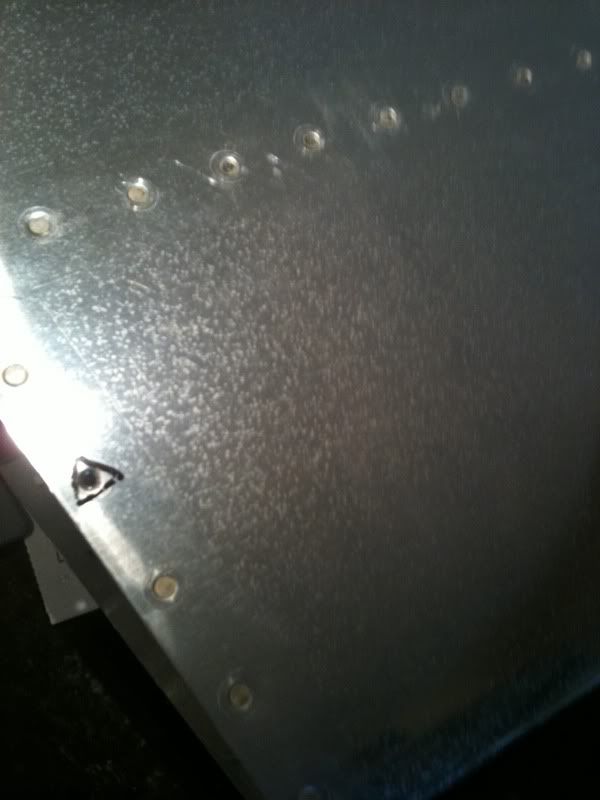

I've been storing my HS from the ceiling of my garage for about a year. When I pulled it down this morning I saw this on the upper surface
It won't wipe off or wash off. Comes off easily with a little rubbing compound.
Should I leave this? Is it OK to compound off? Thoughts?

you could scotchbright and etch and alodine it

I've run into this polishing planes for customers years ago. I would wash it off with a aluminum prep then polish. Going this route you will know for sure all surface corrosion is gone before prepping and painting.

I had the same thing since; but I assumed it was due to my build being stretched over 8 years and the parts were stored in some humid Hawaiian weather. I was surprised to see it since the 2024 alcad on the surface should be T-0 (annealed and not suceptable to corrosion). Scotchbrite or some other physical process seems best. Don't do what I did and next apply WD40 to the surface because it can seep into the rivet to skin gap and may not not be completely removed during the painting prep processes. Paint doesn't like WD40.

Greg - I'm even hesitant to use rubbing compound for that reason. There's no silicone in it, but there is mineral oil. I just finished the left wing and I'm now concerned the same will happen to it. Is there anything I can do to prevent it?

I don't know how to prevent it-other than leave the plastic on as long as possible. Perhaps the question should really be: Is it doing any harm? Most oxides form a protective barrier to prevent more corrosion--problem solved.
I would defer to someone smarter than me to confirm this for our Alclad sheets. Anyone?
Sure is, Acid wash it with Alumiprep, Alodine and prime it NOW. Problem solved...

Or wipe it down with some Boeshield, ACF-50, Corrosion X, or LPS 3, that should prevent any futher progression until you get around to painting.

All of those products sounds like they are also lubricants. Won't they interfere with future paint adhesion?
