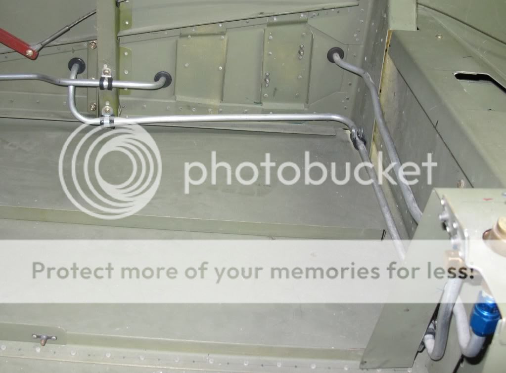

I'd like to see the plumbing.
Are you using two pumps instead of a valve?
I HATE the idea of fuel lines and valves inside the cockpit.

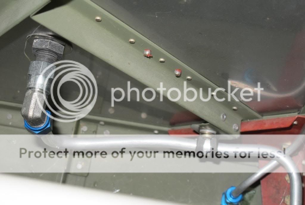

Fuel is drawn from the wing tanks to the standard Vans supplied fuel selector. From there it goes to the single fuel pump and gascolator, then back inside the fuse to the firewall connection and on to the engine pump. The plumbing will eventually all be covered by interior upholstered panels and carpet.
Hopefully these photos will make it a bit clearer
I added a couple of reinforcing brackets to help support the hardware. Not my best work as one is not as well aligned as I would like, but then no-one but me was ever supposed to see it
Clive
