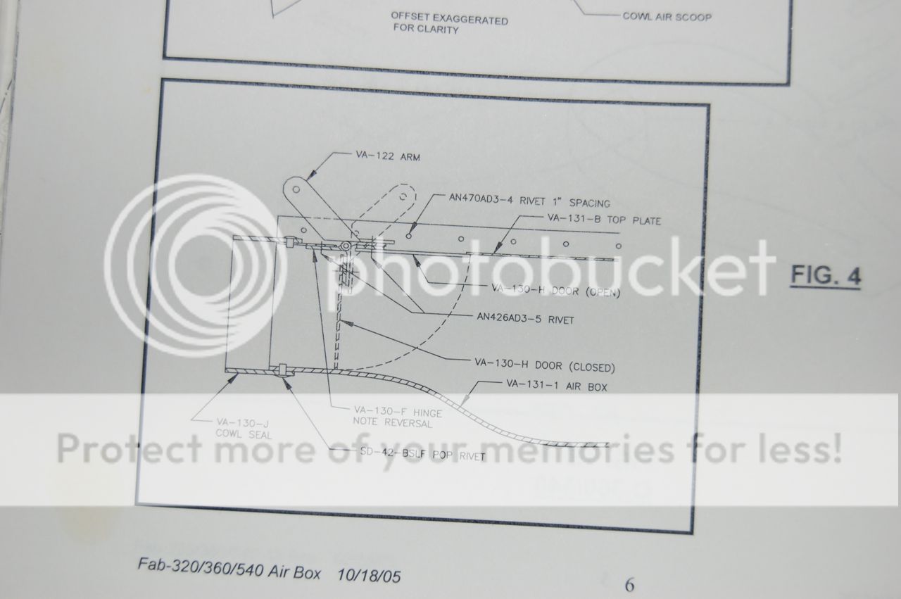

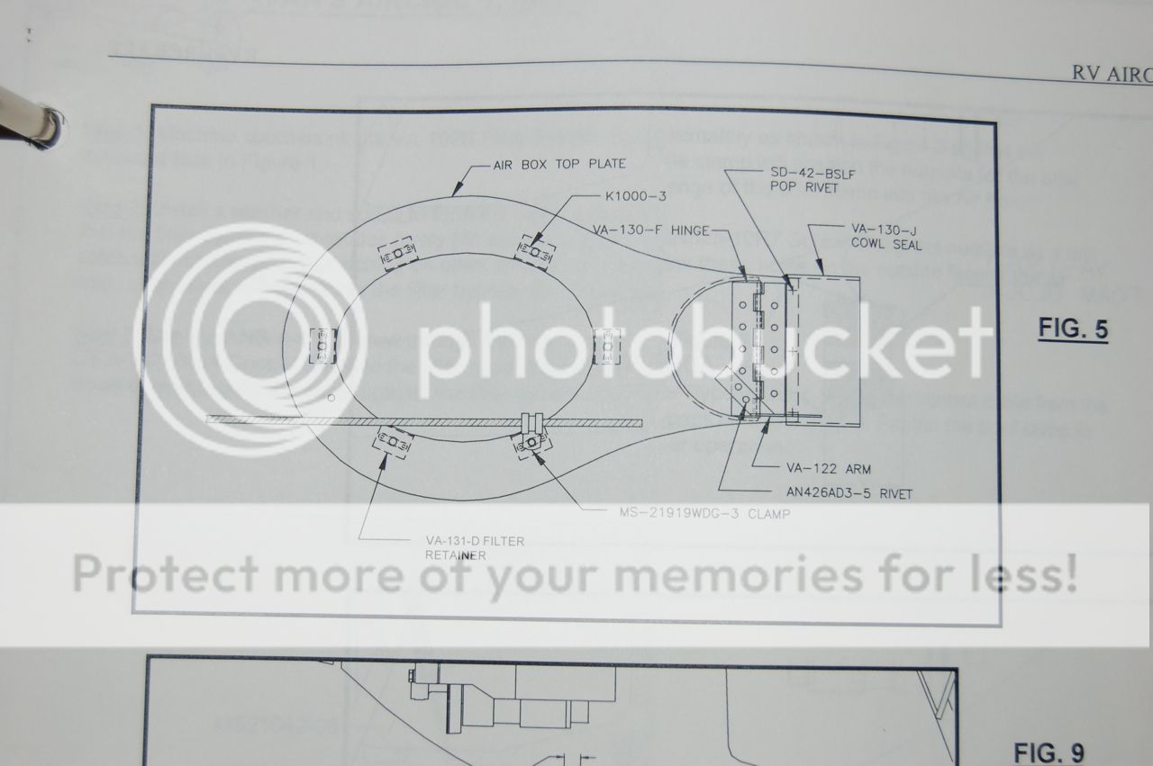

Can anybody tell me what the spec is for the air box rivets? I can't find my plans and some rivets have turned up missing in the conditional inspection.

Here we go John. All you need

Thanks Vlad. Just what I needed. I wish more drawings were available on line.
