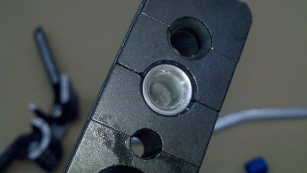

With all the discussion on this thread, I thought I'd share how I've made my flares and solicit positive/negative feedback.
Please, let's not debate the type of material used, rather the technique of making the flare.

14- Here's what it looks like ready for attaching the cone shapped part of the flaring tool.
15- Flaring for about 1/8 to a 1/4 turn, followed by reversing to relieve the pressure, then repeat seems to work best for me.
16- Dont' forget to use a little lube. Any type will work. Helps keep from scoring the flare.
17- Here what it looks like when finished. After a couple practice flares, you'll be able to feel the added resistance when the flaring is complete. Don't push through the extra resistance, or else you'll over do it.

19- This shows how wide the flare is. I believe this is the maximum it should be. If it were any wider, it wouldn't fit into the B-nut well. Experts out there confirm? Update: indeed this example is at or exceeding the maximum limit. 3/8 tubing should result in a flare that is 0.460 - 0.490 inches in diameter.

Let me be the first to say that your flares are way too big.
This causes unnecessary thinning and hardening of the aluminum.
There is absolutely no need to have a flare that is larger than the ferrule.
You do not want to squeeze the flare into the die, extend it a bit further
out of the die and use approximately 4 half turns to make a flare on a 3/8 tube.This will create a flare that is just a tiny bit larger than the ferrule.
You can use a sharp tube cutter,deburr the inside,scotch brite ouside, flare, scotch brite again and you are done.

How does your flare diameter compare to the dimensions in this spec?

12- On this type of flaring tool, flush with the edge is appropriate for making the flare.....
Are you sure that is accurate?
I believe that the tube should extend 1/8-1/4 inch beyond...

If I rely on MS33584 for Jim's 3/8 tubing example I would look for an absolute max diameter of .484 with an allowable undersize flare diameter of .474. SAE J533 shows .46 to .49 as acceptable diameters. Does it really not matter which standard I apply?
For the lower end number, the "J" spec specifically allows a "slight flat" on the outer edge. This is not shown in the MS spec. and could easily allow for the 0.014 difference...
