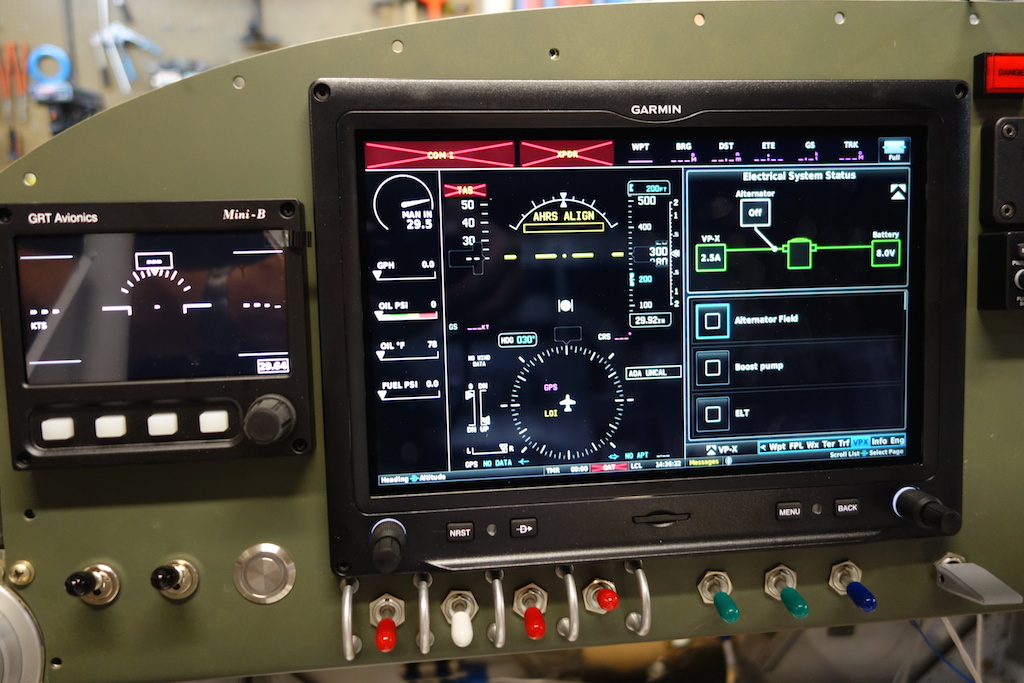

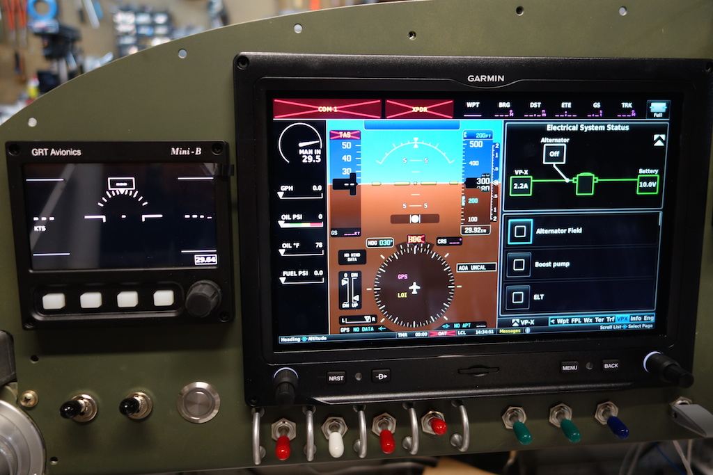

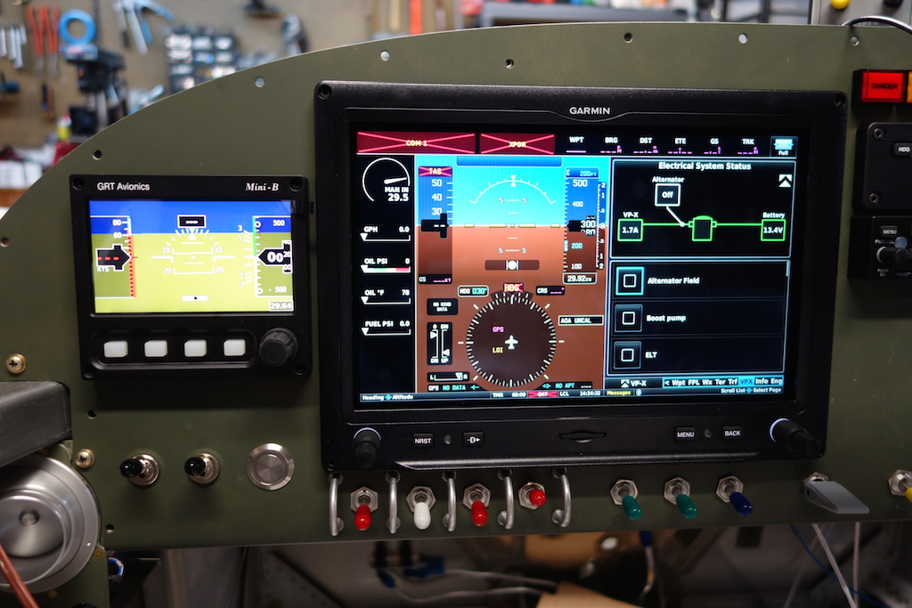

Tonight, I did some experimenting with voltages and what falls off when...
Everything's running at 12V+, of course.
At 10 volts, the Mini-B drops into Low Voltage Error Mode
At 8 volts, the G3X Touch AHRS drops off
At 7 volts, the G3X Touch display starts failing
Here's a sequence of images demonstrating this.
Everything Running:
Mini B dropped offline:
G3X AHRS about to fail:
Lowest voltage where the G3X display works:
