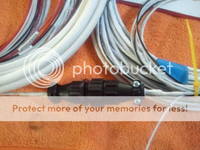

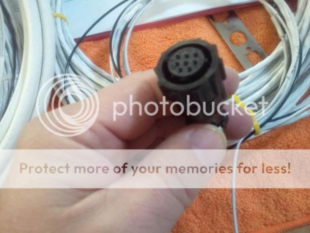

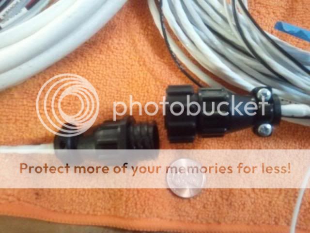

Default Have you considered a CPC connector?
It would cost a little more than butt connectors, but the next time you want to change units (say the XX96) it will be much easier.
