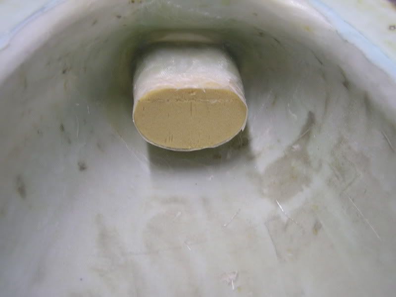

All of the above are good suggestions, but as with Van's instructions, they have you carving a hole through the center of the foam, trying to get it contoured and allow for the thickness of your layup. I found it much easier to reverse the process. I started with a cylinder of foam a little larger than the air intake, which I jammed into the intake from the rear. Shape one end to match the contour of the intake, and the other end to match the fab contour. It is easier to smooth the cylinder than a hole. Do your layup on the exterior of the cylinder, and you are done.

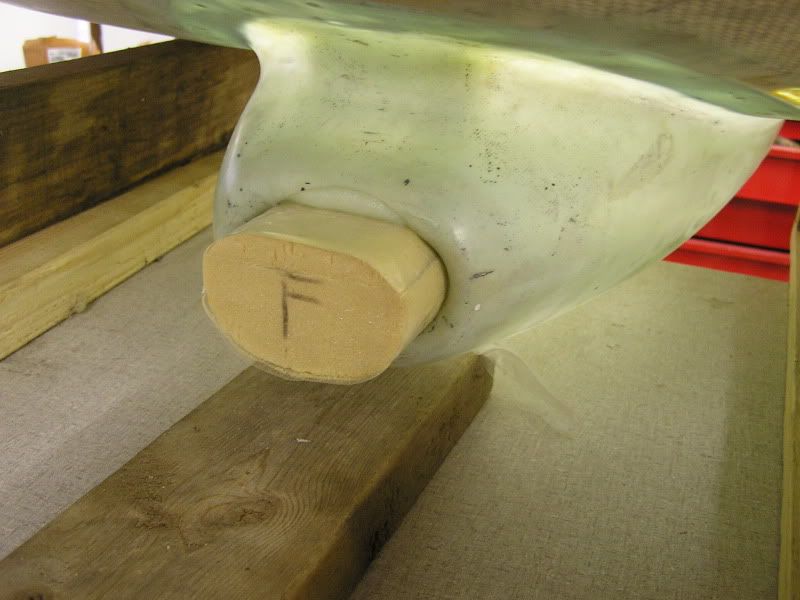

This is how I did mine. This was a repair/rebuild but it has the same result you need, Bob. I made a foam plug that fit through the opening of the snorkel. I first made a little cardboard template to transfer the shape of the opening to the end of a piece of foam about 5" long. (I had to laminate two pieces of foam together to make it thick enough to make the shaped plug). It was long enough to protrude out the front and back as far as needed. I band sawed the shape oversize then used another chunk of foam like a sanding block to shape the plug to size. Just rub the plug with another piece of foam to wear it down to the final shape and size. Then wrapped a layer of clear packaging tape around the foam plug and shoved it in the snorkel opening. Line it up straight and secure it with tape on the front outside of the cowl. Then I used about five layers of fiberglass cloth to build the tunnel. I used shorts pieces about two to three inches wide and tucked them around the plug. shorter pieces overlapping where easier to handle because it is kind of a reach getting in there. I used a paint stick to tamp and poke things around. Once it harden overnight, I carved the inside of the plug out to remove it and was very surprised how well it worked. I added some resin and flox to the inside fillet to strengthen it some and a little micro on the outside to patch it up a bit. I was quite pleased with the result...
I hope this is clearly written.
