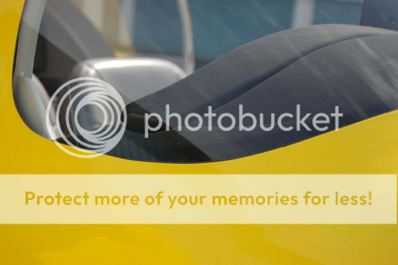

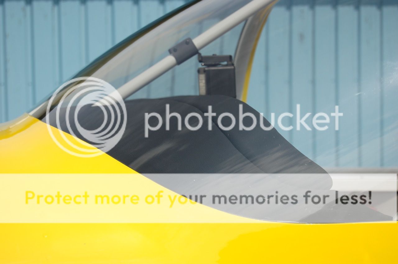

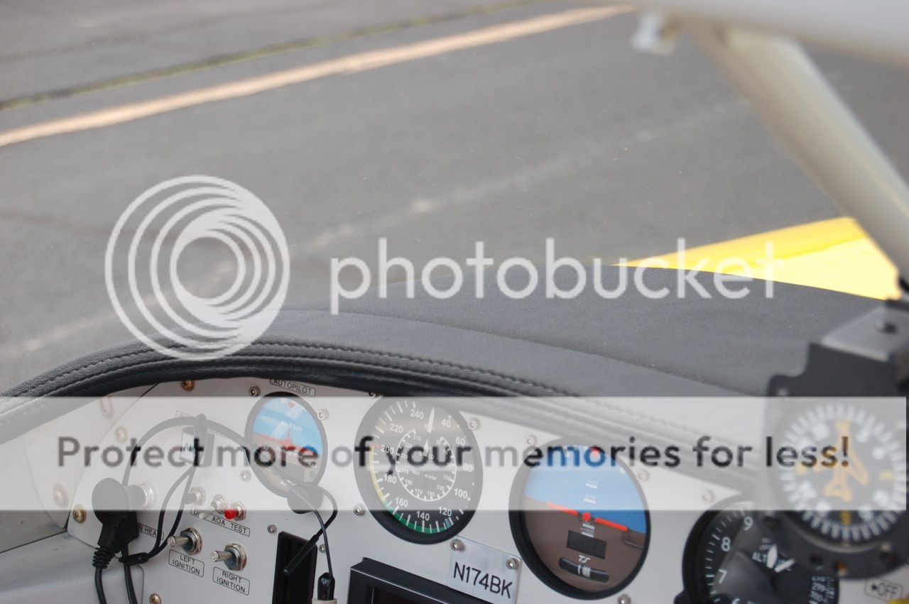

Old 06-26-2011, 05:56 PM
Posts: 8,145
Saw Tony's craftsmanship today. Looking great! Here are couple pictures
Hey thanks for the ride buddy! I had a good time.

Thumbs up Outstanding
Very nice Tony. I've been shoving that antenna farm problem way back in my head because I couldn't come up with a good idea to conceal it. Got one now! Thanks
