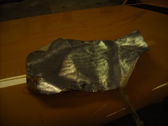

Several weeks ago, I found a burnt fuel line as you may recall, so while I had the cowls off, I decided to buy some insulation from ACS to cover the exhaust-scorched areas of the lower cowl. I cleaned it well with denatured alcohol and Xylol mix to ensure that it stuck well.
Last week, while cruising at 8500' with an OAT of 65 deg, my oil started up to 198....199...200...and ended up at 203, without me touching anything..throttle, mixture...nothing..Hmmmm?
Thinking that it could be a bird's nest, I uncowled it today and the oil cooler was clean...no trash nor bird's nest. My helper was around the other side and the bottom cowl was still on , he asked, "what's this plastic stuff here?"
The insulation blanket's adhesive had melted and the thin layer let go, with the blanket kinda wadded up and blocking the air exit of half the opening around the exhausts!:
This is what I removed from the lower cowl....you can see where it got burned by the hot pipes!
If you know your engine well, be very alert if ANYTHING changes for no apparent reason. I was getting a subtle 'message' and found out that the old gal does in fact "talk" to me. My oil usually runs around 190 and CHT's around 375 and they had crept up to near 198 and 400 respectively.

What kind of glue did you use? Maybe somebody that has had success gluing insulation in the lower cowl can tell us what to use and what not to use. I just bought some for mine and would like to do it right the first time.

Default It's self adhesive.
Originally Posted by DEWATSON View Post
Pierre,
...What kind of glue did you use? Maybe somebody that has had success gluing insulation in the lower cowl can tell us what to use and what not to use. I just bought some for mine and would like to do it right the first time.
It comes with its own adhesive and you peel off a waxy coated paper. The stuff felt like I'd have to scrape it off, it was so sticky. It had a sort of cloth weave backing, purportedly to keep the cowl from getting scorched. Apparently the heat from the exhaust softens the glued coating during taxiing. I think it's a lousy product that should be pulled from the shelves.
It had been on for around 5 hours before this happened. On our -6A we used a very thin, shiny foil that was also really sticky and I sold the airplane after 500 hours and 5 years and the stuff was still completely intact.

Pierre,
The cowl heat protector that Vans sells works great. I have used it on my RV8 and RV10.

call browns, http://www.brownaircraft.com/searchresults.asp?cat=104, get the ct-190 and the fireproof glue they have for it and your problems are done. hight temp silicone around the edges. this stuff is incredible. you will be very happy. you will plenty left over to sell on vaf to needy rvers. why acs sells such junk is beyond me.

That's the stuff Mardy. I had seen the 300deg notice but I figured that my bottom cowl doesn't get that hot....don't waste your money.
