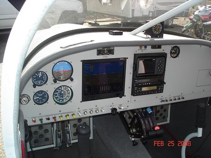

Here is a picture of the original panel

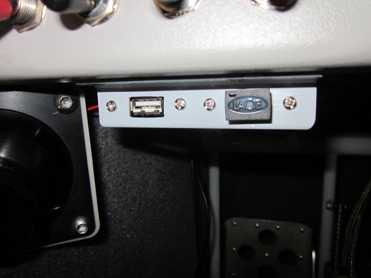

I mounted the USB ports under the panel as shown in this picture.

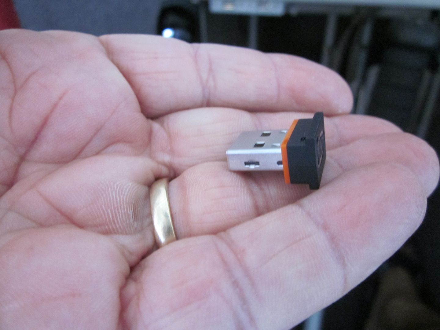

The USB flash drive is a 8 gig and only sticks out about 1/4 inch. It is big enough to hold the free 4 gig approach plate folder so we have all the approaches in the country and still room to hold demo files of flights. This usb flash drive is called a Lacie mosKeyto flash drive and I found it on Tiger Direct.
