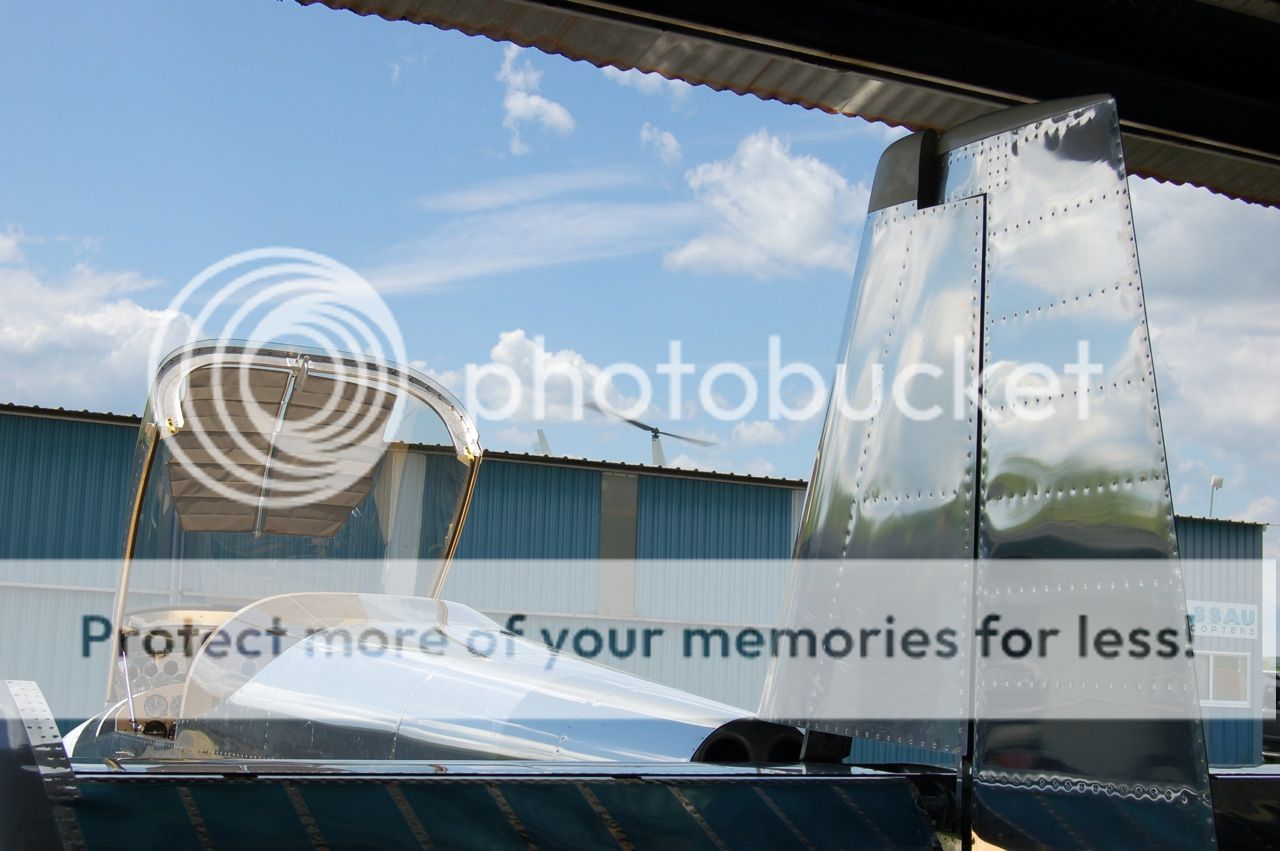

Doug's front page article on getting an internet connection at the hangar prompted me to post this regarding the system I put in this past year at my hangar.
First I installed antennas and radios for a 4 mile link from hangar to the wind generator tower on my property where other network antennas are located.
http://www.cherryfamily.net/gallery/...BkrGth%2F68%3D
Then inside the hangar on a 'retro' desk, system with large monitor for displaying full size drawings (excuse the mess).
http://www.cherryfamily.net/gallery/...PzHJJ%2FXXk%3D
Small video window on the right, is a webcam monitor to watch my driveways at home while at the hangar.

Oh, forgot to mention, in the antennas photos, there are 2 main antennas, the parabolic for the backhaul link (4 miles) & the white vertical rod for local coverage so pilots can pick up latest weather, TFR, etc.
