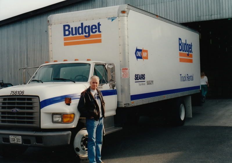

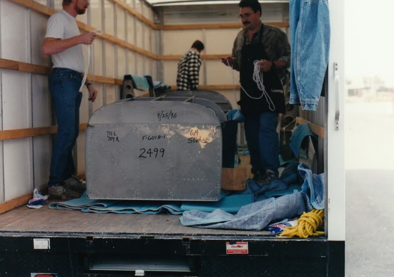

I inserted a couple of photos of the truck I rented to take my quickbuilt RV-6A from North Plains, Oregon to Laguna Hills, California on 11-11-96. Note that it has an included ramp in the rear of the truck. I used desk mover platforms with casters bought from one of the big Home Stores (I don't remember which one) pads, foam, blankets, etc. and all went well. The only problem that may exist depending on the condition of your plane is the landing gear width - if it is attached you may have to remove it or carefully insert the fuselage at an angle to get it in.

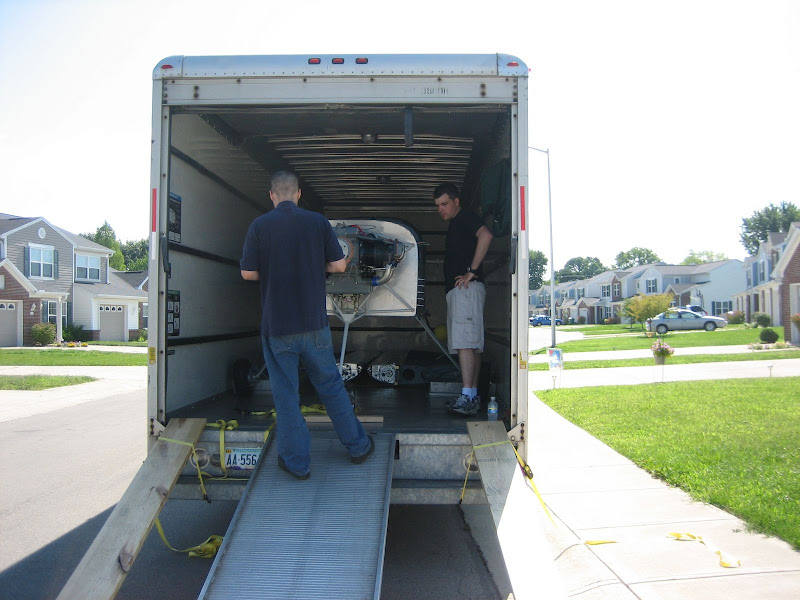

This probably wasn't the smartest idea, but it worked. I had people watching the wheels while we pushed it in to make sure they didn't get too close to the edge of the boards. The nose wheel made this method difficult.
