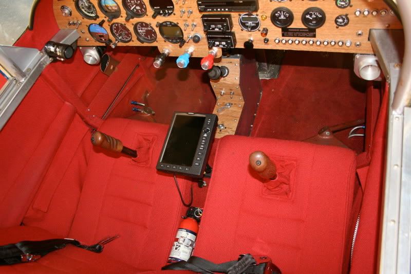

I opted for the 695 instead of the 696 because I did not want the WX weather. I mounted it down between the seats on out RV-6A and it comes up fast and works every time with the internal antenna. I have never lost the GPS signal flying within the 48 contiguous states (I mention that only because many years ago flying with the original Garmin GPS 90 I lost it while flying in a race in Canada and I have never flown the 695 up there).
I do not like the artsy graphics on the 695 as well as the business like display on the old GPS 90 or the Apollo MAP 360 driven by the SL-60 but that is just me. The unit is a very reliable navigation reference but at least where I have it mounted without geo referencing the approach plates are useless. I ignore their presence all together even though that was probably the feature that I valued most in purchase decision. I gave up on Jepps after many years of being a customer because the cost so much now that I cannot justify buying them. I subscribe to a very limited set of loose leaf form government plates for the local states and by the bound form books for every trip even though I prefer the Jepps products. This works and is much more cost effective for my applications.
