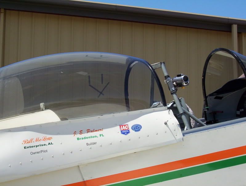

Very nice video, and the comment about too long between maneuvers will be more apparent when you have an actual acro box to practice in. You'll also find a little difference in the time between maneuvers depending on whether you're up wind or down wind. Since the RVs don't have symmetrical wings, the nose on the roll will be above and below the horizon to remain level like a Decathlon. The roll looked good to me. Very nice spin too. My RV will not spin well to the right. To consistently align the 45 and vertical lines, I have a sight on my canopy that looks like an "X" and two vertical lines. Since my head shifts going up compared to going down, I needed the two vertical lines. The lines are the stick on tinted auto windshield lightest tint (32 percent). Good luck in your next competition, and GREAT to see another RV competing in IAC.

I like that idea of taping some lines on the canopy to help with the 45 degree angles. I find that sometimes the first 45 degree upline is too steep. I'm just eyeballing it but a line would be helpful. I think I will try that.
