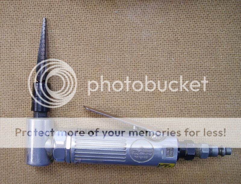

So I realized I should have enlarged the tooling/conduit holes in my right wing so I can run my AOA tubing through some bushings rather than take up room in my flex conduit. But the ribs are already riveted to the main spar, so I can't drill the hole larger (7/16") with a normal unibit. I have a 90 degree drill adapter, but it wont chuck the large unibit, and I dont see any threaded base 7/16" drill bits available for it either. So other than finding a REALLY long drill bit at home depot that I could plunge all the way through all the ribs from one side, any ideas?
Basically, you can see in this picture, the bushings I want to be able to install in my other wing as well as the un-enlarged tooling hole.

Suggest a smaller Unibit. The 1/2" size should fit. I've used this size in a 3/8" right angle cordless drill (Milwaukee or Bosch 12V) in some real tight spots.

Check at the tool dept. in your local lumber yards, home depot etc. you can find drill extensions in many different lengths. They work like this, one end has a hole for your unibit and two allens that secure it and the other end chucks up to your drill. Maybe you can give that a try. I would think that you would need and extension just long enough to get through the root where the doublers are and after that an air drill and unibit should get the rest. Just a thought.

I used exactly such a setup to drill the conduit holes in my quickbuild wings. Kind of scary looking in progress, but it worked just fine.

I bought a cheap unibit from Harbor Freight that had a narrow hex drive shaft. I ground off the corners of the hex drive shaft until I could get it to fit into the small chuck of the angle adapter. Worked good enough, and not expensive.

Also, if you grind it so it is around 1/4 inch diameter it will fit in a cheap HF angle grinder... may be a bit more compact than the angle adapter -

I chucked up the opposite end of my unibit in a bat powered drill. Put some tape around it to keep from dulling cutting edges. Dress your grinding wheel true/smooth. Run the unibit shank up against the fine grit grinding wheel while spinning. Wear your safety gear while doing this.
I also used my 90 degree with a 1/4" burr bit from Lowe's. Just mark your hole with a sharpie. Rough cut with the burr. Then take some 120-240 grit sandpaper rolled around a 1/4" to 1/2" dowel to smooth out rough edges.
