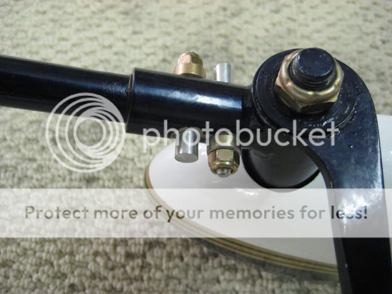

Thanks for the information. Now for the real question. The tailwheel fork assembly has quite a bit of side play on the mounting shaft. A larger through bolt has been used with some help, but the play still exists. Any suggestions?

Taper pins... do a search, you should find it. Many folks have done this and it works quite well. Pretty much eliminates any play from that point forward.
Here's a picture:

More dumb questions. Is this the standard mounting procedure for the API tail wheel? Most of the tail wheels seem to have two through bolts mounted horizontally.
Should I consider adding a second vertical through bolt or is one adequate?
Are the API products still available and if so where?

I'd be willign to bet that if that isn't a really old RV, thre are two horizontal holes already in the tailsping (behind that vertical hole). All you have to do is find them, and put bolts and /or taper pins as shown in post #6
