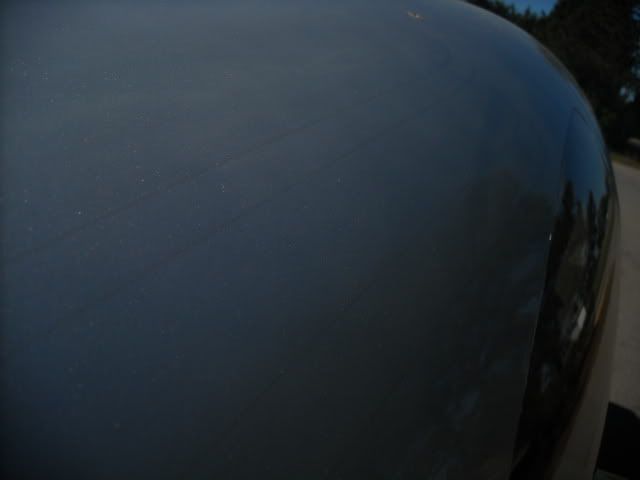

I decided to add roof-mounted handles so shorter/heavier passengers can more easily board my rather "tall" RV-10...handles like Vic Syracuse and others have.
I didn't want them at odds with the airflow, so I borrowed an old trick to find the airflow direction and mount the handles at that angle for the least drag.
Several drops of old oil above the rear windows and a quick flight showed me what I wanted to know:
[IMG][/IMG]
I then placed two felt-tip black marks parallel to the air stream....voila!

I hadn't thought about that trick for years Pierre - thanks for the reminder. Of course, it means that you actually HAVE to go fly as part of your modification project....isn't that a drag....

I used that trick many years ago, when I laid up lower intersection fairings for the Cassutt I'd built, to see what the airflow was doing....worked well.
Surprisingly, the airflow was in a similar direction on both sides of the -10 and was surprised that the spiral propwash wasn't evident like it is on the Air Tractor. The left window on it gets sooty from Jet-A but not the right.
