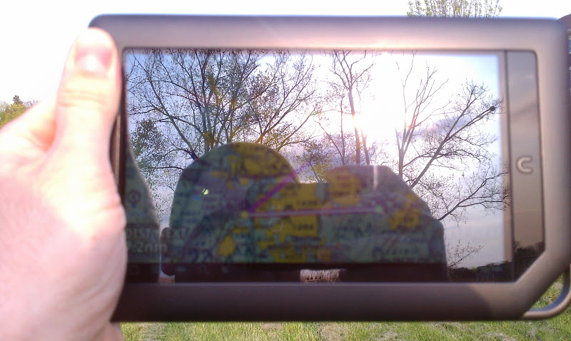

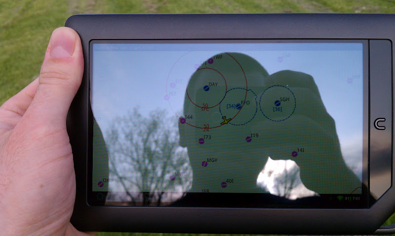

I snapped a few pictures outside. The sun was starting to set, so it wasn't exactly direct daytime sunlight. You can see the reflectivity is probably one of the biggest problems. There might be some matte screen protectors you could get.
This one is another app called Navzilla.

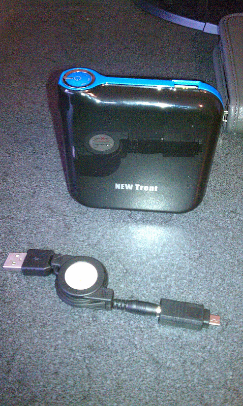

And for USB power I bought one of these:
http://www.amazon.com/New-Trent-iCru...4212039&sr=8-1
At $80 it's a bit pricey, but it can put out 5V 1A and has a capacity of 11000mAh. That should be enough to keep your phone going for a week

As your pics show, full sun is a issue. The screen is bright enough - but the mirror effect of the glass is a problem. However the B&N folks have a matte film that goes over the screen that supposedly solves things. I'll have to look at it a bit more.
