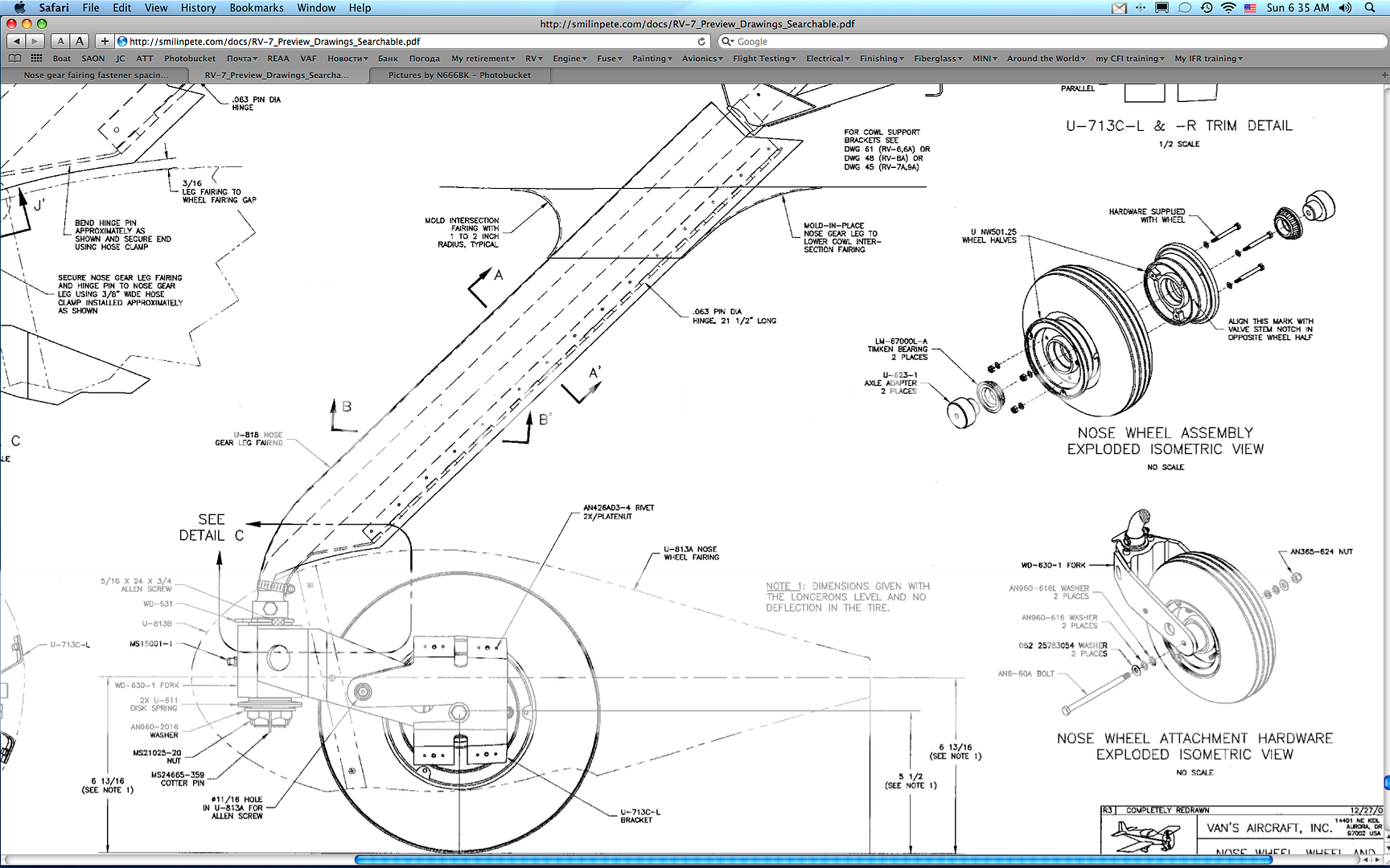

I cannot for the life of me find the call out for the spacing of the screws that hold the nose gear leg fairing halves together. These dimensions are clearly called out on the main gear fairing drawing (C2) but a similar view on the nose wheel fairing drawing (C1) has no dimensions. It would seem that I could use just any spacing but they actually use the middle screw hole as a reference for another dimension on the drawing so I better put those screws in their proper places. What gives?

Drawing C1 for RV7A clearly shows three evenly spaced screws on each side of nose gear leg fairing (6 screws total). Should be similar for 9A. I will take a close look tomorrow and post.

Thanks Vlad but i must be blind. See the three screws that are in phantom in the view you posted? How far apart are they spaced? Where do I locate them? I'm just not seeing it.

There is no spacing indicated indeed. The drawing says it's 1/2 scale I think the distance could be 3 3/4 ?

Yep, I resorted to throwing a ruler on it too. That can't be what Van's had in mind but oh well, it will work. Time to build on!

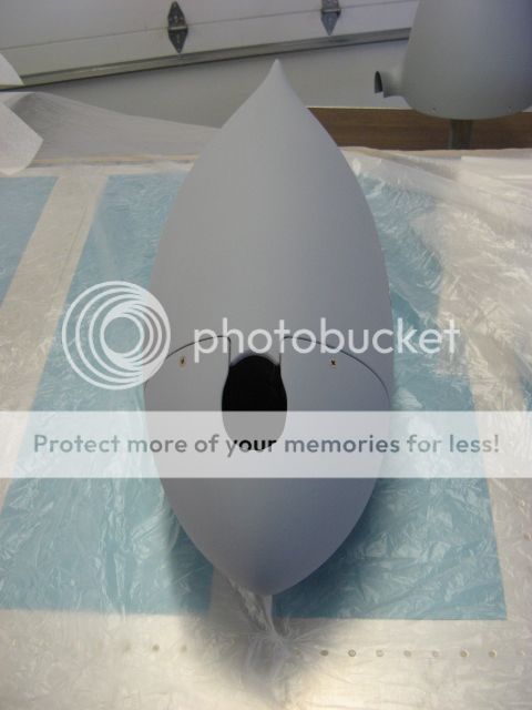

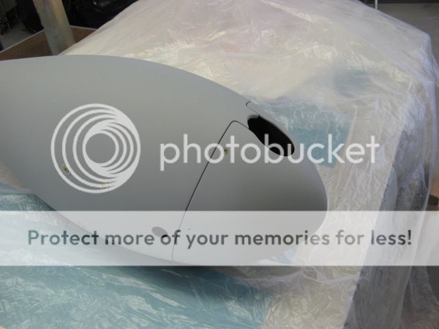

Found couple neat pictures on Paul Merems website.
