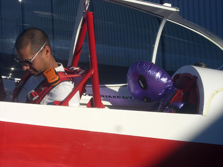

Hi Guys,
I'm just trying to figure out how to handle the XM antenna in my 4 . The small cockpit and side tip canopy are making it a little challenging . I could possibly mount it on the fuselage under the canopy but the cable would have to be extended . Has anyone done that ?
Any suggestions would be appreciated !
Marc
That is the location of mine. Works well. Look behind the purple alien.
