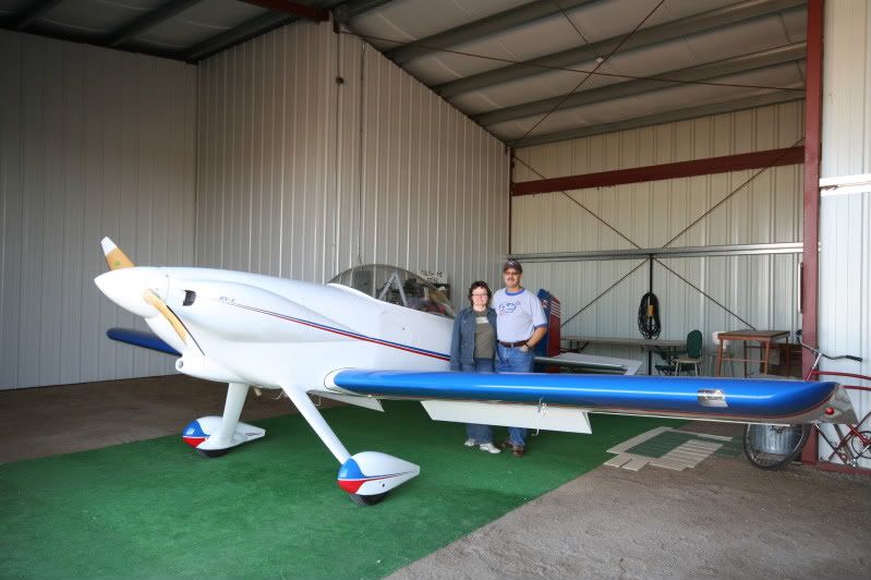

Craig, this is what I used for my hangar...have had it for 9 years now...works great, cheap. It is indoor/outdoor carpet or deck carpet....comes in 12ft width so you could seam it if you wanted to do the whole hangar.....put a cup and pin in and you could practice putt when its raining....
