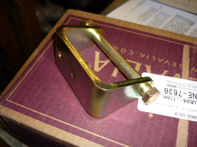

Here is the spot where the boss mount for my PP alt to go...but as I you can see I do not 2 matching holes to bolt the alt boss mount unto the engine. this engine previously had a generator which was removed and won't be coming back...Can anyone help me here.... what am I missing? You will notice that there are 3 case bolts missing in the pic..I am assuming that these spots were use to hold the generator.
Also, the other pic is the starter platform. It has 3 studs screwed in already but one appears to be missing. I have seen other engines like this too. Anyone know which thread bolt I need to screw into it.? I just bought a new skytech HT starter and would like to install it.

If I interpret your photos correctly, that square boss is for your starter - you do NOT have a boss for the alternator. You'll need a case-type alternator mount - not the one you have.

You need the case mount bracket shown in this link for your alternator http://www.plane-power.com/images/ly...conversion.jpg.
The starter just has 5/16-18 course thread bolt in that position on my engine.
