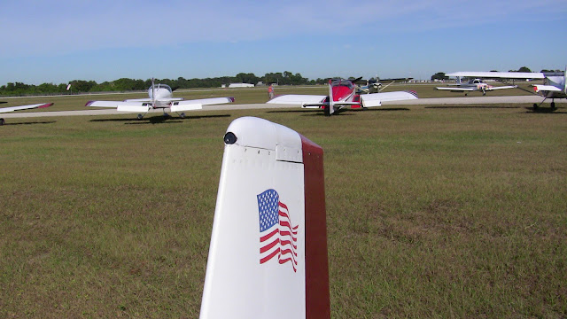

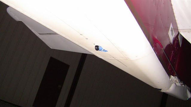

I put one on top of VS and one on the belly below VS:
Dale
RV6a 1450 hrs, 180 videos
Youtube channel same name: RV6AirplanePilot
Last edited by RV6airplanePilot : 03-16-2011 at 06:27 PM. Reason: correct picture ref
