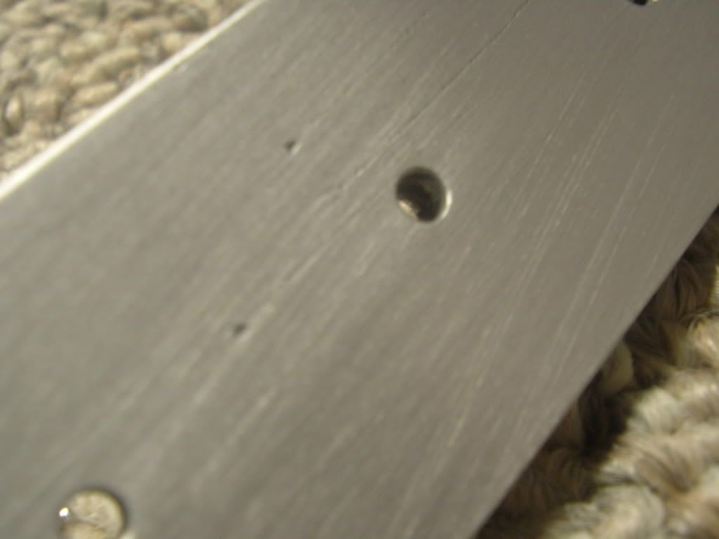

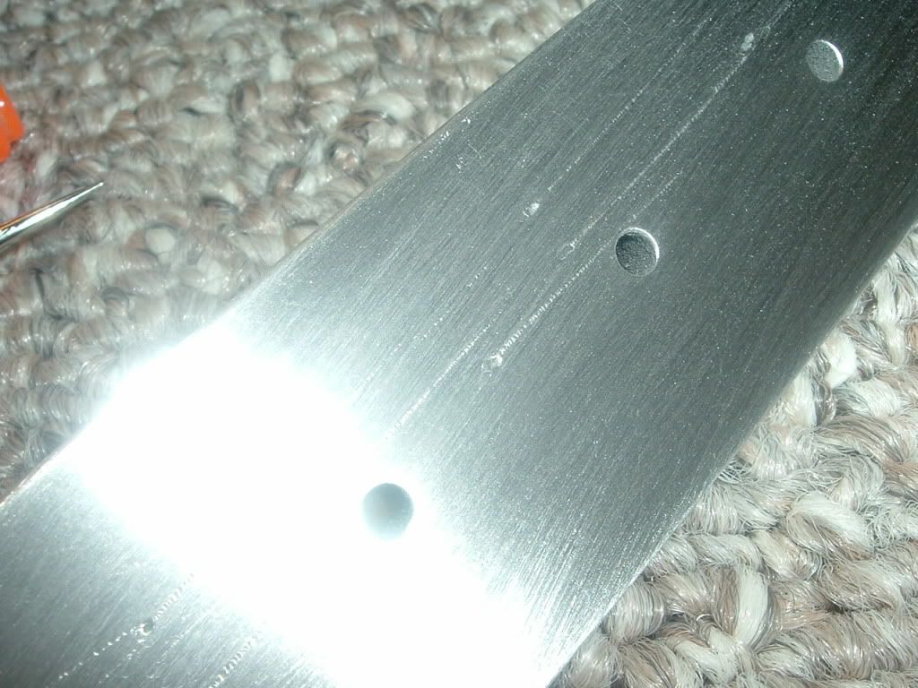

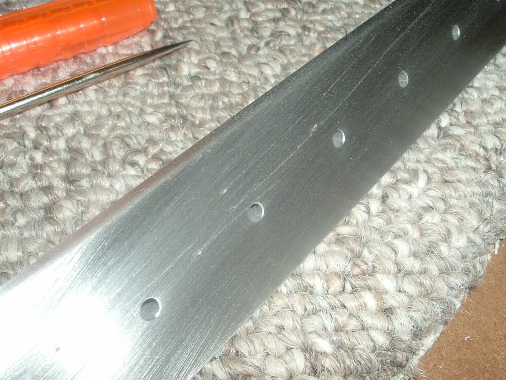

I have just started my RV-7 empennage and have a concern about MY hs-609PP spar reinforcement bars.
There are a number of gouges in the face of the the reinforcement bars that although I do not think will be a concern I would like to get the opinion of others.
The gouges are not that deep, but are too deep to file or sand out as I think this would remove too much material. I have smoothed over these gouges with scotchbrite to ensure there are no sharp edges.
What do you think? should I build on or call Vans for replacements?

A general "rule of thumb" for blending is 10% of materail thickness. I would attempt to locally blend them out just a little more, alodine, paint and install.

You will find other parts and pieces like this as you progress through the kits. These look superficial to me. A little sanding with emory cloth and it should buff right out.
