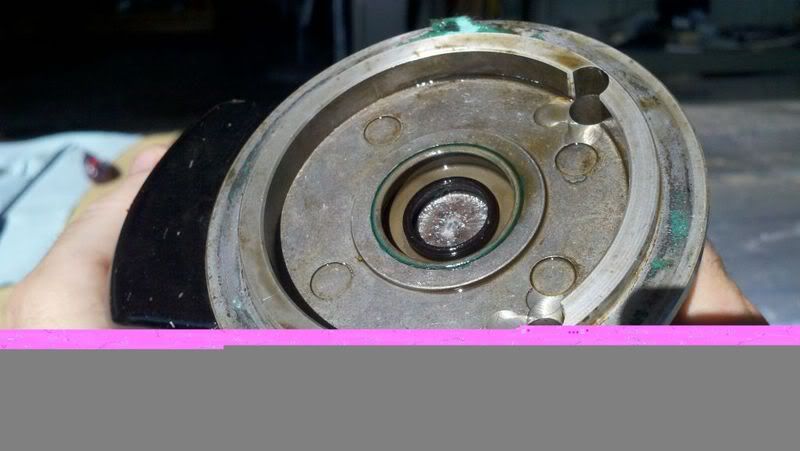

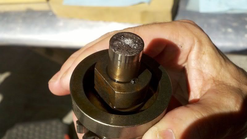

The mag shaft is completely sheared at the entrance into the mag housing.
It happened just after takeoff on downwind, with the symptom being a very short decrease in RPM (constant speed prop) and then a return to normal. My passenger (a very experienced pilot) wondered if it might have been a slug of water in the fuel. I then noticed the LASAR failed light on and returned to the airport and landed. It never ran rough but I did a quick mag check on the ground and when the switch was turned to "L" the engine would have died if I didn't quickly go back to both.

After takeoff, on downwind, my rpm sagged momentarily. It behaved as though there was either a slug of water in the fuel or I had turned off the mags and then back on as quickly as I could. The engine ran smoothly after the initial sag. I returned and landed and did a quick mag check. The left mag was dead. This is a LASAR system.

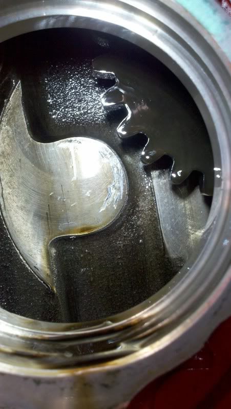

The only troubleshooting I could think to do without taking the mag off was to check the mag switch with a DVM. It was behaving correctly. I pulled the left mag and was alarmed to see that the shaft was sheared very cleanly at the point where it enters the housing.
I emailed pictures to my engine builder. He said he had never seen a failure like this. His guess was that either the shaft seized in the mag housing and the engine continued to drive the mag and something had to give and that was why the shaft broke or a foreign object caused an interference fit between the drive gear and the driven gear. He then suggested that I contact the Slick representative at Champion Aerospace, who are now the owners of the LASAR system. He assumed that they would probably want to see this.

Alex: do these photos show the same kind of failure as you experienced?

Jeremy, I do not know what the broken shafts on mine looked like. I sent both of them to (then) Unison, and upon bugging them, learned that the shafts were somehow broken internally. There was discussion of the mags being covered under warranty, so I didn't disassemble to have a look. They were covered, btw, so I personally had a acceptable financial experience with regard to the three failures. I suspect those days are long ago history.
I do not believe that some engine related vibration causes these problems. Again, I would speculate it is a torsional vibration mode within the mag, or some internal misalignment. Something is causing cyclic stresses leading to fatigue failures.
