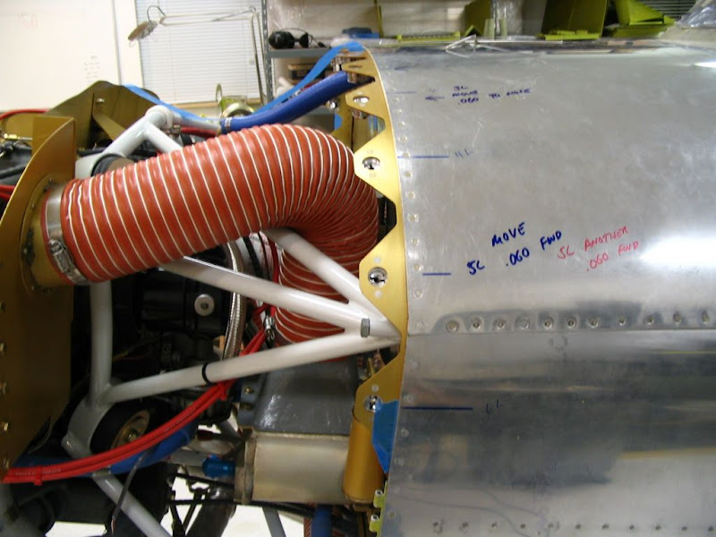

How many skybolt fasteners are required across the top rear cowling on a RV8? That's the only place I'm not happy with the hinge pins. Also, what width and thickness aluminum is required to make the scalloped mount for the female portion of the installation?
Old 12-28-2010, 12:31 PM
Bill Wightman's Avatar
Bill Wightman Bill Wightman is offline
Join Date: Aug 2005
Location: OKC, OK
Posts: 687
Default 13 on our RV8
Across the top aft cowl edge, we've used 13 Skybolt fasteners, spaced equally. They're mounted on a .063 segmented flange:
The cowl sides are done with hinge as per plans.

This may be a stupid question but what is the difference between Skybolts fasteners and Camloc's,,,,both performance and price?

Skybolt fasteners are more sophisticated than the standard run-of-the-mill quarter turn. Skybolt offers a full line of fasteners having features that are well suited to our application, such as adjustable depth baskets, floating interface, stainless construction, wide contact flanges, etc.
The fasteners you see in my picture above are the SK245-4 floating type.
