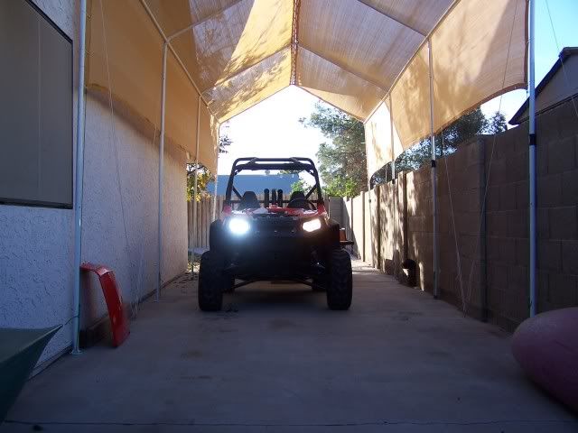

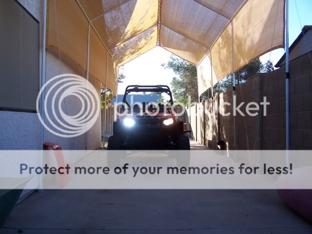

I have been running these on my Polaris RZR for over a year trouble free. I had another landing light blow on my RV6 and decided to make the change to HIDs there and on the RV8a as well. The H3 bulbs fit the Duckworks reflectors on the RV8A. The 6 has standard aircraft bulbs but I had some reflectors from offroad cases that fit. Ductworks sells PAR82 reflector/bulb holders if you need them.
Lifetime warrantee. 35w- $25 55w-$35 I used 5000k bulbs for purer white. 3000k(yellow)-12000k(purple) available. Can't beat the price.
http://www.ddmtuning.com/
Difference on the RZR

55w HID left, 100w aircraft halogen right.
