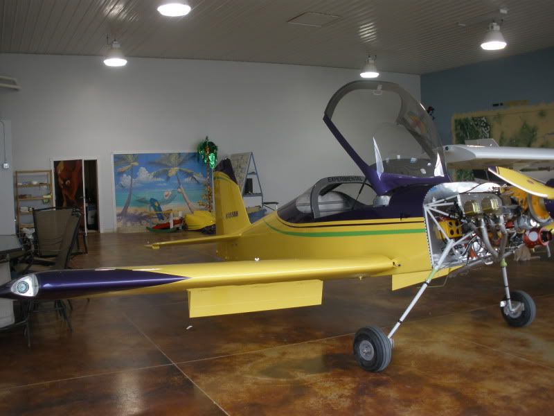

Last week the outside temp was well below zero...the hangar dipped to 50*F. So we turned the floor heat up to 60....yeah it gets rough out there
since we're rubbing it in, I'm hangar sitting this winter, while the owner goes to Texas
