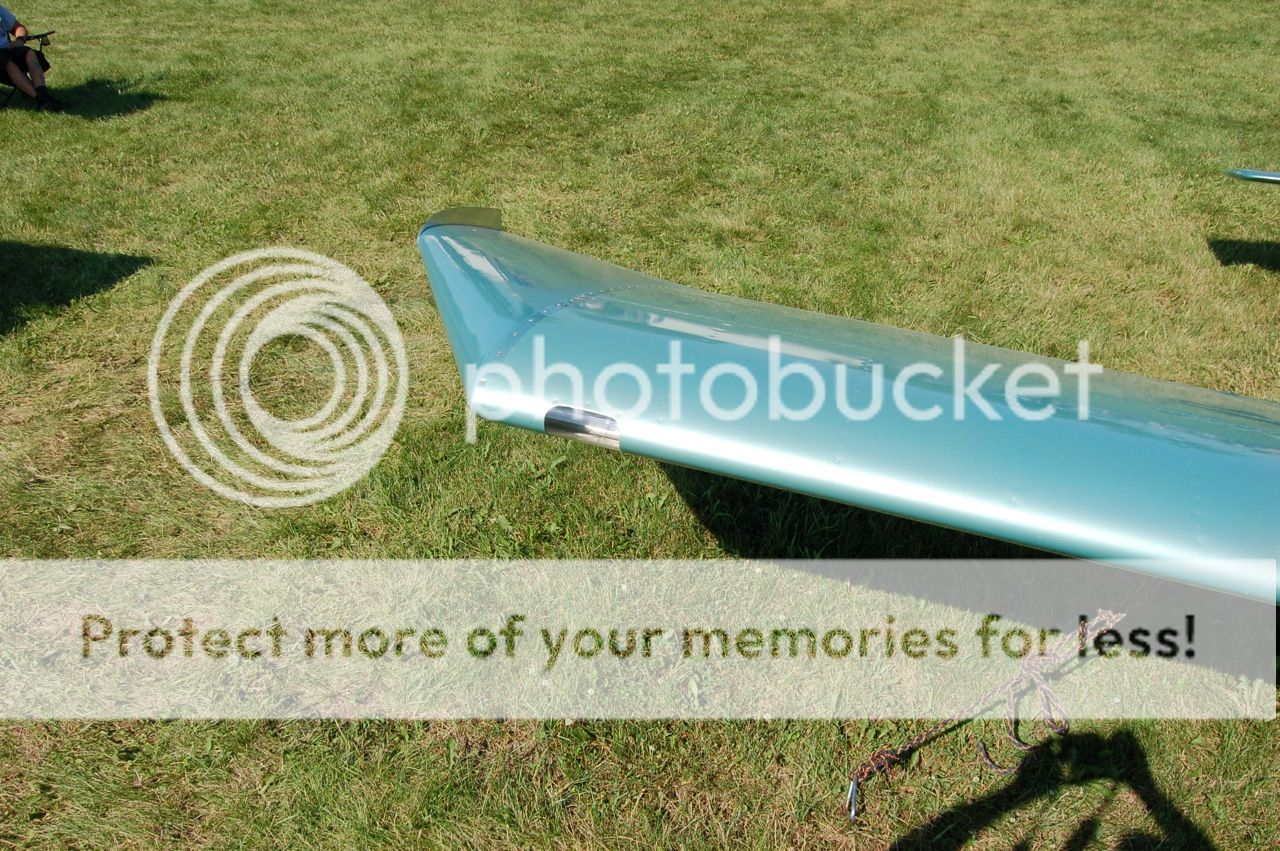

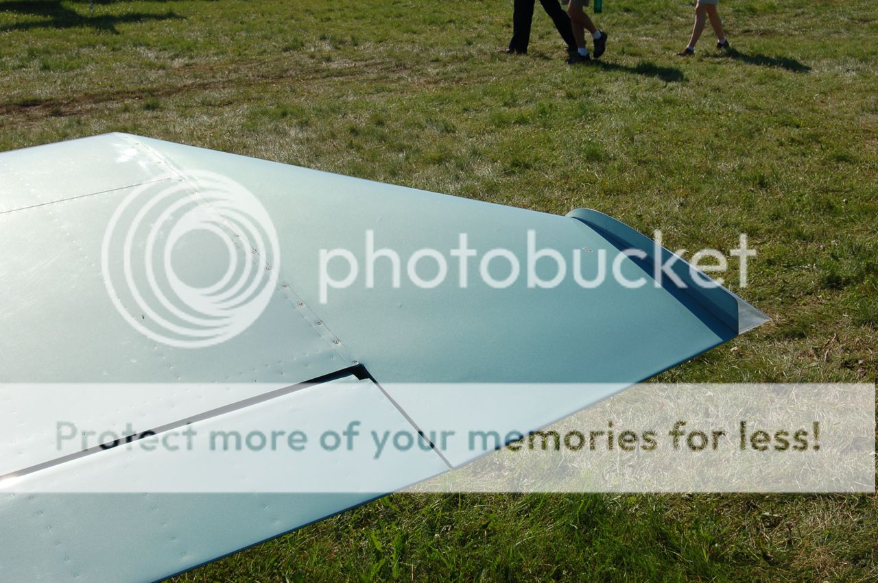

Old 11-20-2010, 09:38 PM
Posts: 8,145
Well, maybe not "worthless" -----but photos sure would be nice
I saw it at Oshkosh looks impressive.
