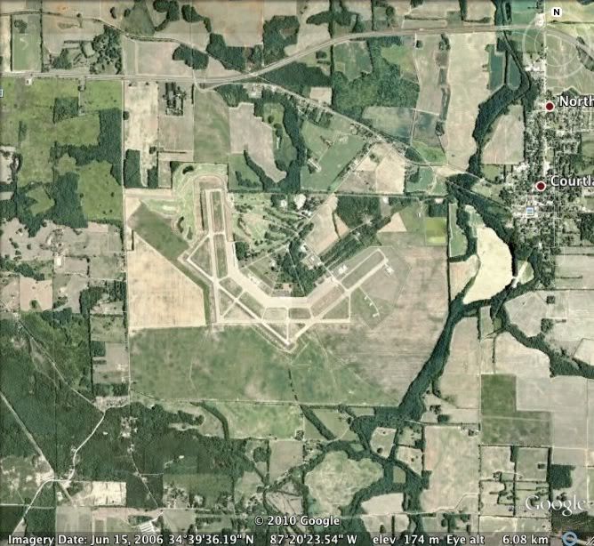

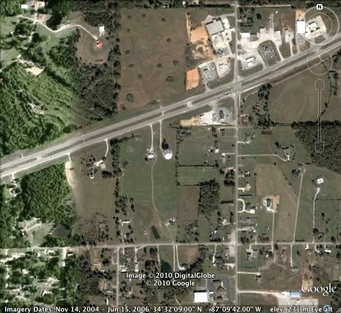

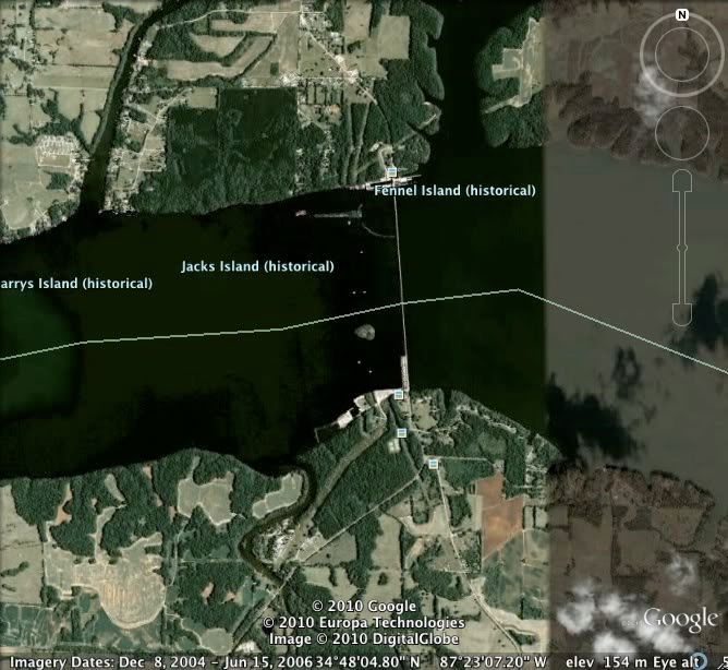

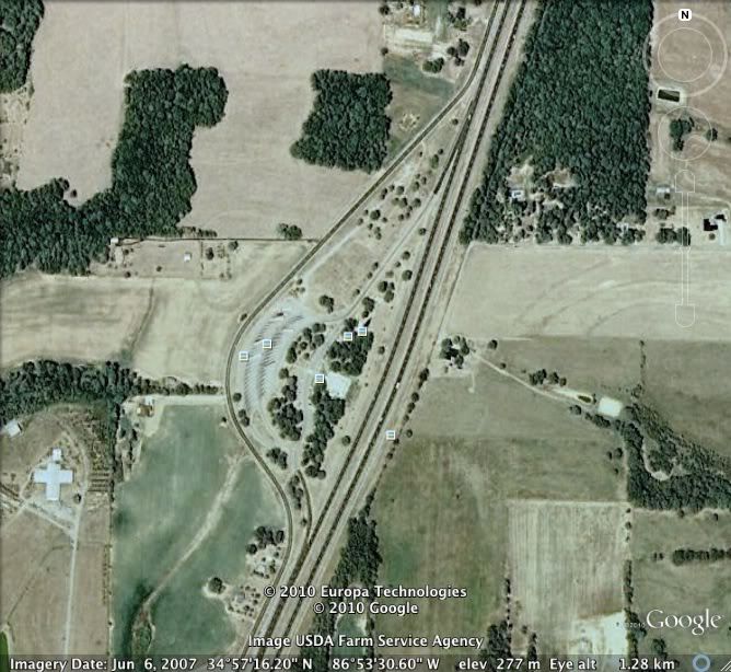

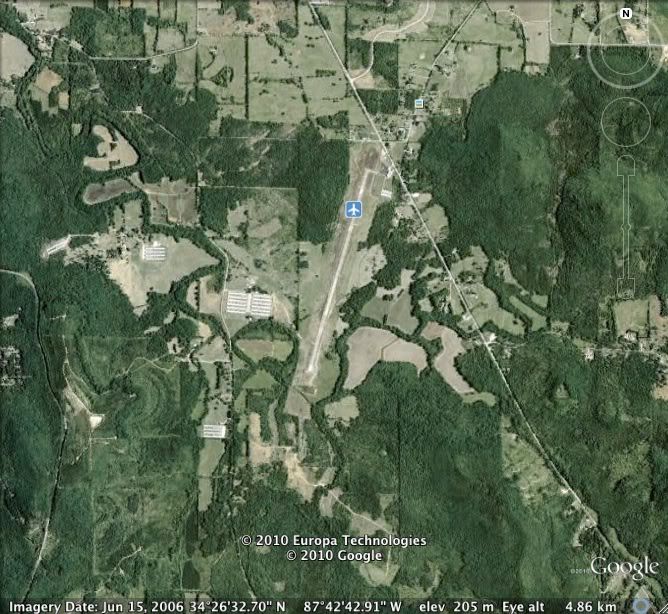

This is just for information although I am coincidently starting my actual flight checklist for the race at courtland, Alabama on 10-10-2010. At the www.sportairrace.org website starting with the Calendar of events checklist SARL race organizer's start, finish and turn points are listed. For the Tennessee Valley III race they are as follows:
Start = Lawrence County 9A4
Turn 1 = 34 32.25'N, 8 9.70'W
Turn 2 = Russellville Muni M22
Crossover = Lawrence County 9A4
Turn 3 = 34 57.27'N, 86 53,51'W
Turn 4 = 34 48.08'N, 87 23.12"W
Finish = Lawrence County 9A4
I go into Google Earth and get an image of the key locations:

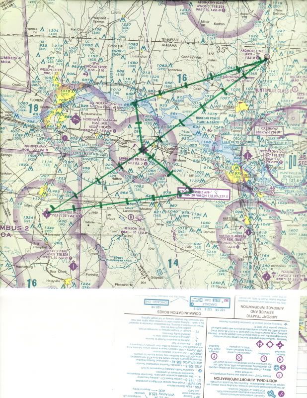

Default Draw the course on the sectional
The next thing I do is use the lat/long and airport symbols to find the key points and draw the course with 5 nautical mile tic marks to the next key point.

Old 10-11-2010, 08:32 PM
Posts: 5,685
Default Turn 1 Check sheet
INBOUND
- Freq = 122.75
- Turn at 1,800 or above east side of water tower
- Call the turn
OUTBOUND
- turn to 262
- Min. altitude = 1200
Caution Note
- Several towers under 1,000 MSL before 12 miles to turn 2 - clear after that
Old 10-11-2010, 08:53 PM
Posts: 5,685
Default Turn 2 Checksheet
INBOUND
- Freq = 122.8
- Min. turn altitude 1500
- call the turn
- Turn wsw of buildings at north end of runway
OUTBOUND
- Turn to 057
- Min. alt 1500
Caution notes
- 1346 tower 4 miles after turn 2 (18 miles from turn 3)
- 1009 tower 5 miles before turn 3

Old 10-11-2010, 09:02 PM
Posts: 5,685
Default Crossover 9A4 Checksheet
INBOUND
- Freq = 123.15
- Climb to min 2,000 MSL 2 miles before airport
- Call Air Boss 2 miles out
- Min. crossing altitude 2,000
OUTBOUND
- Turn to 054
- Min. alt 1400
Caution notes
- Many towers below 1220 MSL
Old 10-11-2010, 09:14 PM
Posts: 5,685
Default Turn 3 Checksheet
INBOUND
- Freq = 122.75
- Call the turn
- Turn east of rocket
OUTBOUND
- Turn to 252
- Min. alt 1200 except for 1700 over Rogersville (5 miles before turn 4)
Caution notes
- 1043 tower 20 miles before turn 4
- 956 tower 5 miles before turn 4
Old 10-11-2010, 09:21 PM
Posts: 5,685
Default Turn 4 Checksheet
INBOUND
- Freq = 122.75
- Min. turn altitude 1100
- call the turn
- Turn over small island west of the dam
OUTBOUND
- Turn to 171
- Min. alt 1200
Caution notes
- 845 tower just right of course near finish
Old 10-11-2010, 09:37 PM
Posts: 5,685
Default Finish Checksheet
INBOUND
- Freq = 123.15
- Max. finish altitude 1500
- Call 2 miles from finish
- Fly over departure end of runway 17 Finish Line
Recovery
- Fly south for slow down - cool down
- land on runway 13 or 31
