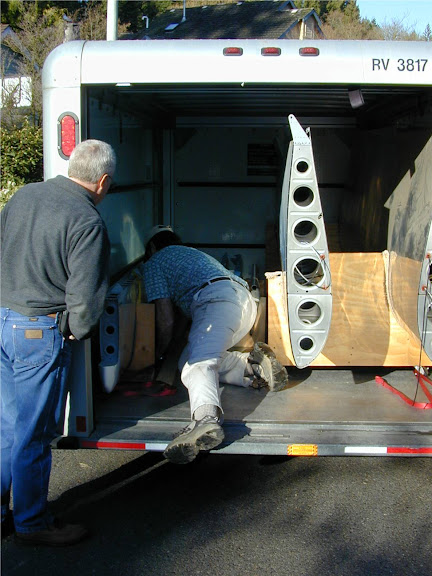

The EAA wing stand in the rental utility trailer.

I hauled mine in a covered U-Haul trailer.... didn't want to risk wind and flying roadway debris damage. One day rental is cheap insurance.
